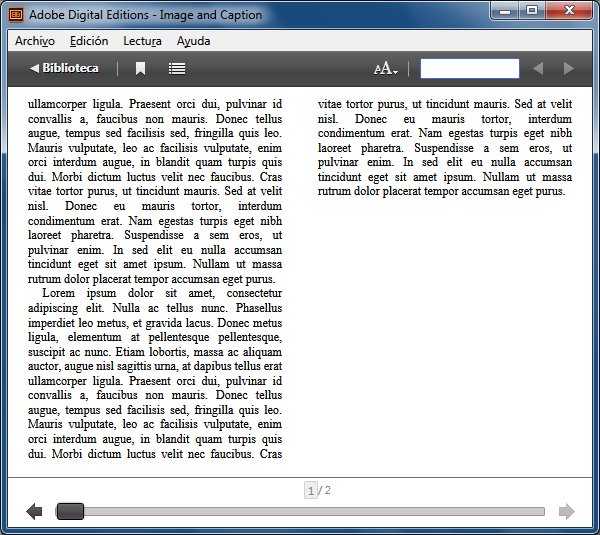

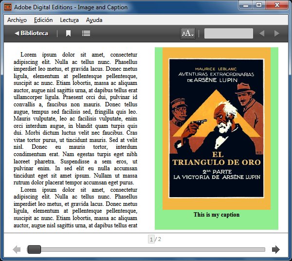

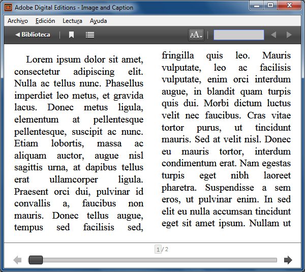

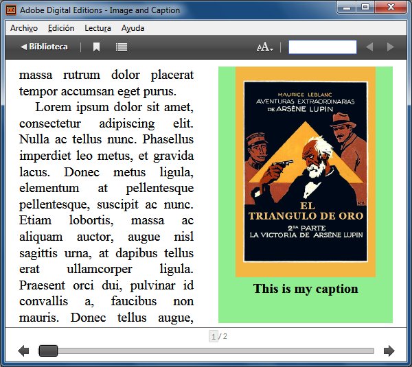

Originally Posted by Falkor View Post
The problem here is 'float'.

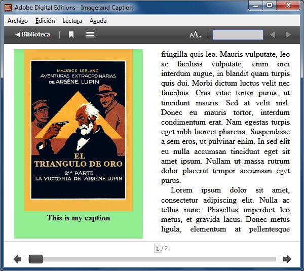

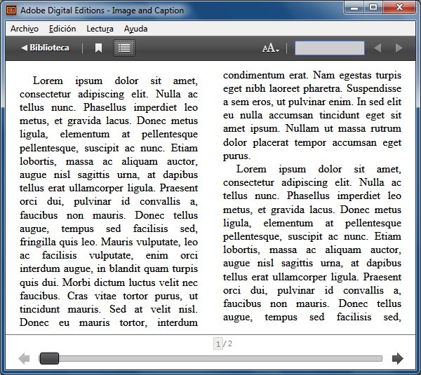

In my tests, even this version that is not for ADE, works fine in ADE 4.5. Watch the following screenshots:
ID:	216549 Click image for larger version
With a bigger font-size:
ID:	216551 Click image for larger version
And with a biggest font-size:
ID:	216553 Click image for larger version
As you can see, the image floats perfectly (no blank spaces; I added a green background so the block can be watched easier). If you have issues to get the same output, then you have something wrong.

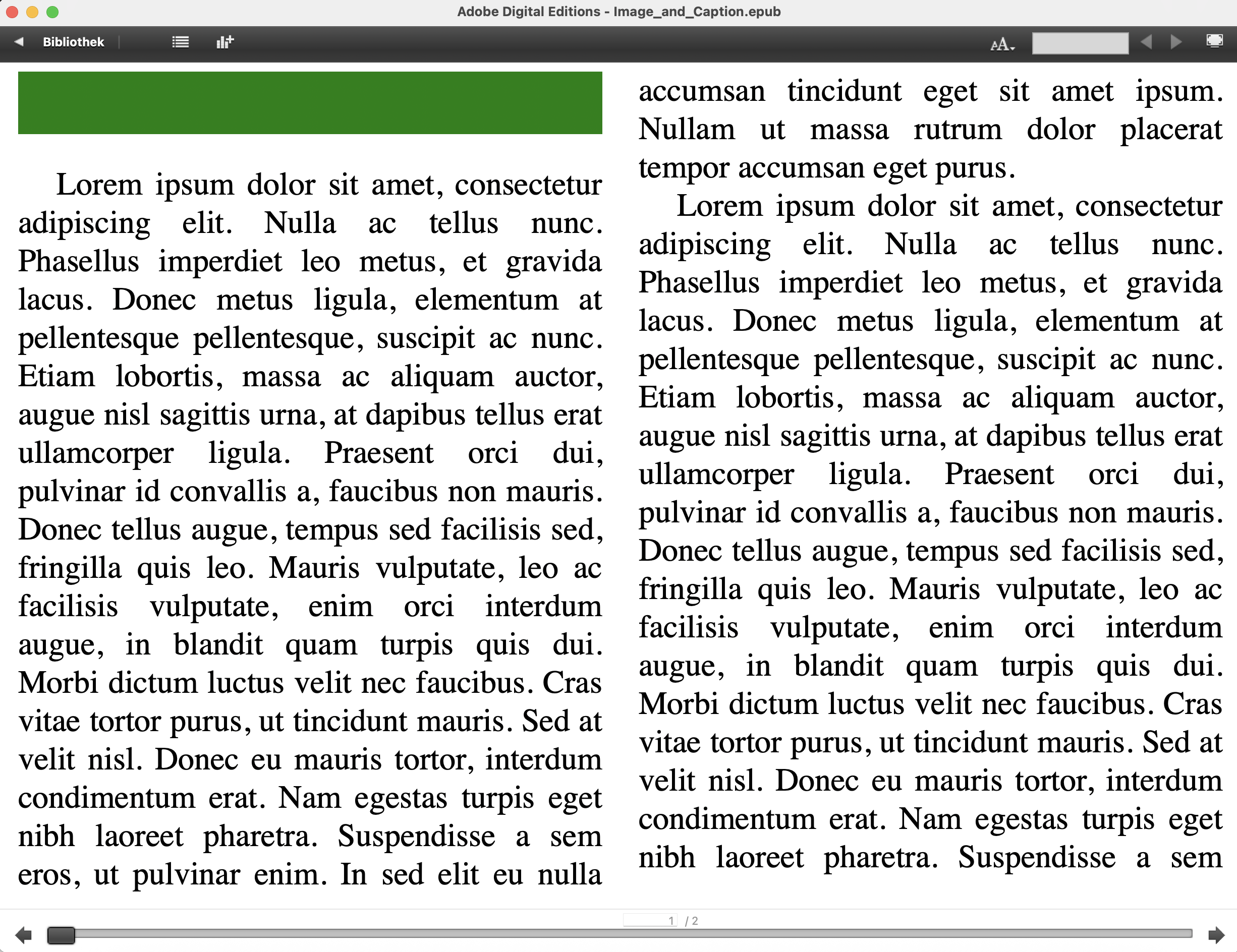

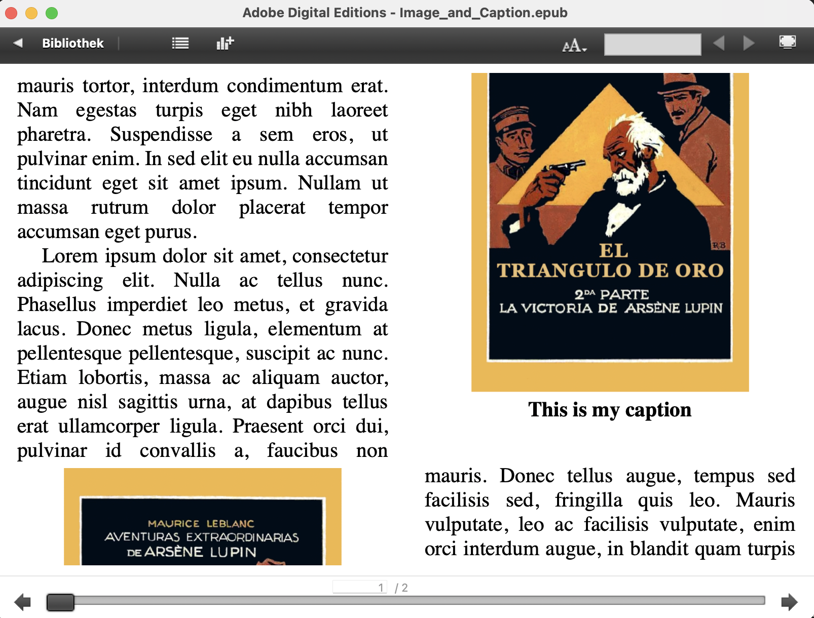

If you don't set "float" then you will have fragmentation in your epub. But you didn't say if you tested it or not in Thorium and Calibre. You said that my sample didn't work there and in the screenshoot I posted you can see that the epub looks fine those ereaders. My code is not for ADE 4.x; as I said in my previous post, ADE needs additional statements in order the things work there.
I found the error in my epub that caused the issues with Thorium and Calibre and I wrote about it in #47.
For ADE and Books I just found a way to make your epub work with float: Don't set the margin to 0. It needs to be bigger (or not set at all). The left and right margins should be set to auto to keep things centered. Works fine in ADE, Books, Thorium and Calibre viewer

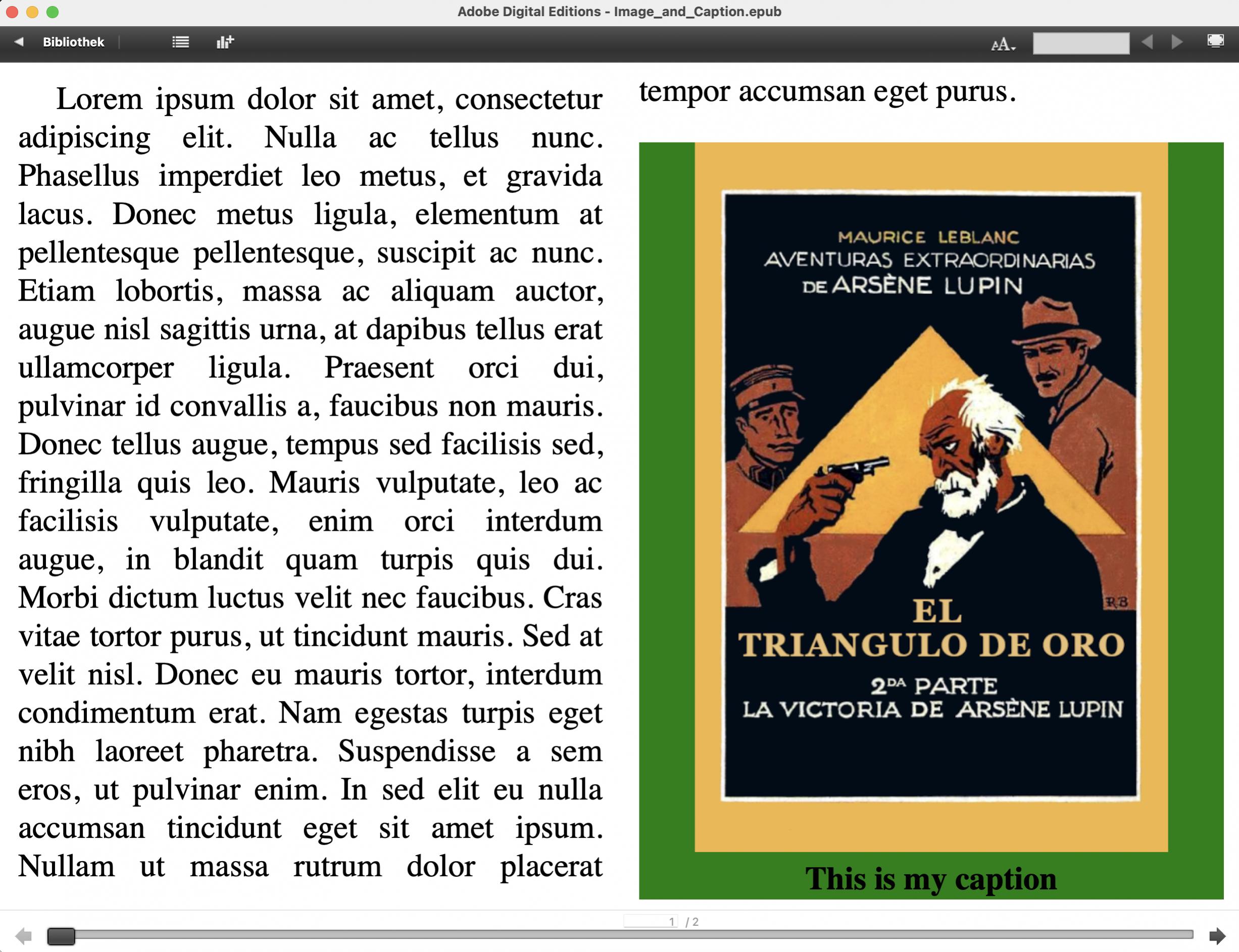

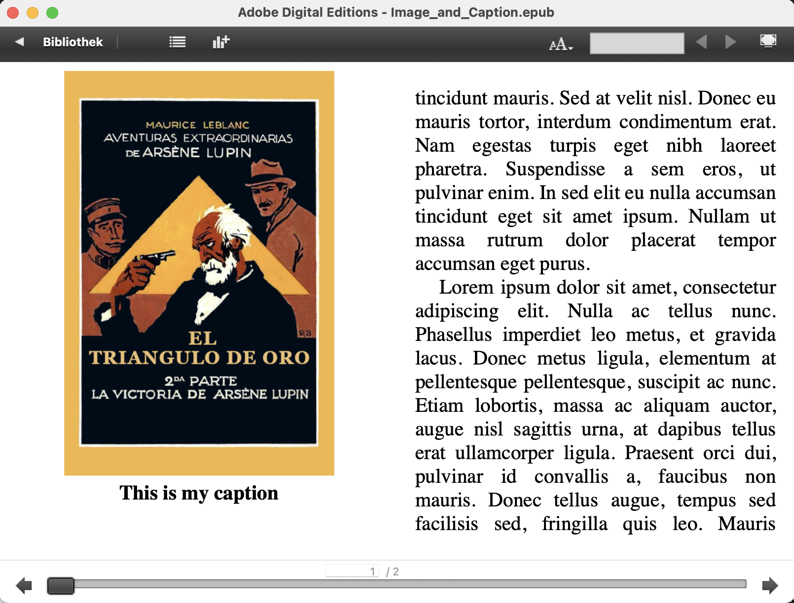

I was using the exact same file you shared.
And ADE has hardly any settings to change, just the text size and the size of the window. There's nothing I have done that could have caused this. Maybe ADE for MacOS is different from ADE for Windows?
I've attached screenshots of the unchanged file and the file with modified margin. It behaves much better, but apparently it's not a perfect fix. Sometimes the layout will still be messed up... but never as badly as with zero margin.
ID:	216559   Click image for larger version
ID:	216560   Click image for larger version
ID:	216561   Click image for larger version

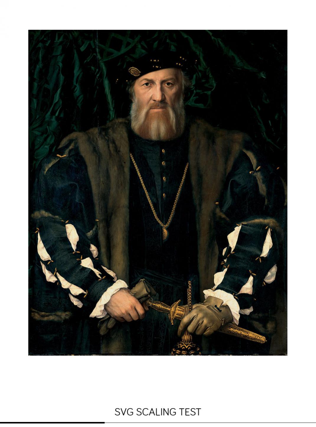

Since I don't have a Tolino Shine 5, I can't test if it scales or doesn't a svg wrapper. But it's hard to believe your device can't handle something as basic as an SVG container. Can you post a screenshot of your Shine 5 output?
And also do the following try:
1. Open Sigil and start a new .epub3 file.
2. Add any image to that epub.
3. With the command Tools/Add Cover... set the image you loaded in step #2 as cover.
4. Save the epub.
After that open it with Shine 5 and post a screenshot of its output. Perhaps Shine 5 has the same behaviour of ADE 4.x under Windows regarding svg wrappers (if so, is easy to fix your issue).

Here you go.
I also tested with 20vh – looks exactly the same.
