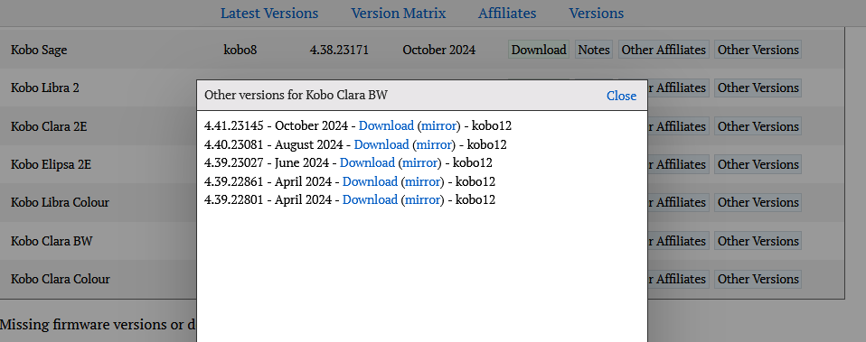

Originally Posted by Edemen View Post
Ok, I have to accept that.
And is it possible to at least downgrade from 4.42 to 4.40?
I won't brick the reader, because apparently that happened when I tried to downgrade to 4.39?
As long as you are using a supported firmware version for the hardware platform you are installing it on. If you look at Patrick Gaskin's Kobo Firmware Downloads page and click on the Other Versions button for the Clara BW, you will see the links to the firmware versions that are compatible with the kobo12 hardware.
I am wondering why you want to use the 4.39.whatever firmware since I can't see any advantage in doing so.
