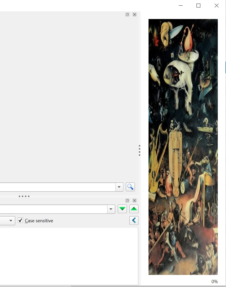

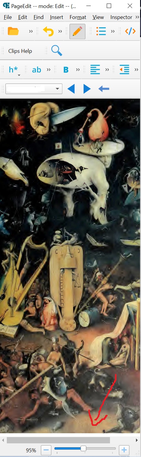

In Sigil and PageEdit, this appeared to work except the image extended a few pixels below the window; setting the height in ".imgfull" to 99% seems to fix this, but i don't know why 100% is, well, more than 100% of the screen height. Additionally, if i narrow the window to the point that so that its narrower than the image, instead of shrinking the image to fit the window, it just adds a horizontal scrollbar. (see fullpageimg1.jpg)
In Calibre, narrowing the window beyond the image's natural dimensions doesn't resize the image, but rather smooshes it (see fullpageimg2.jpg). Otherwise, it seems to work like Sigil/PageEdit
Now, bearing in mind that the perhaps an svg wrapper would work differently, I'm still curious why THIS didn't work. Is there something funky in my styling? Or something missing? And why do Sigil and Calibre render this differently?
[NOTE: attached images are with the height for "imgfull" set to 99%, not 100%]
ID:	216223   Click image for larger version

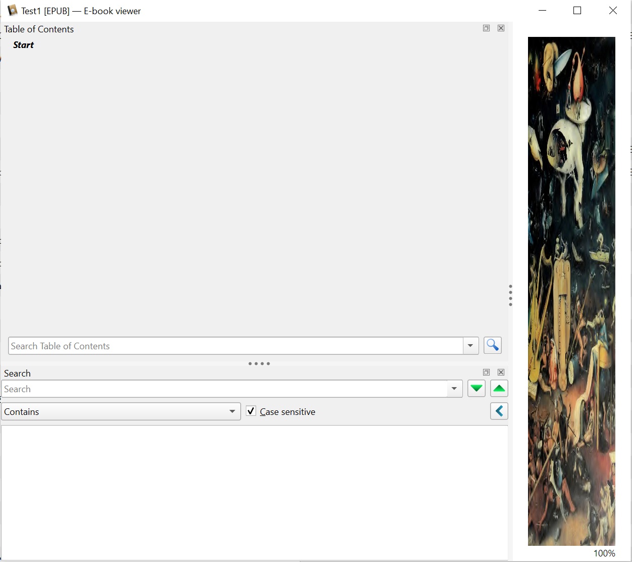

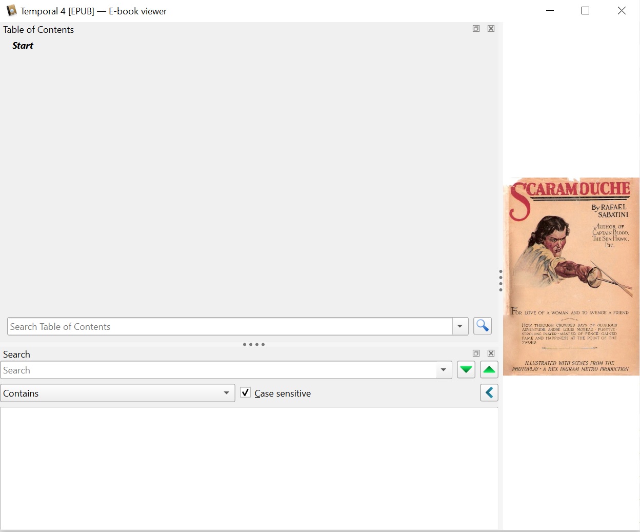

One moment! When you say Calibre, what do you mean? Calibre Viewer or Calibre eBook Editor? You can't compare Sigil/PageEdit with Calibre Viewer; you need to compare Sigil with Calibre eBook Editor. And both of them, display the same image when you resize the Preview Pane. Regarding Calibre Viewer, it doesn't honor the code inside the epub. Open my Temporal4.epub with the Sigil's plugin Readium and you'll see that the image has the same behaviour as in Sigil/Calibre eBook Editor.
As I said, Calibre Viewer is not honoring the epub code (the image doesn't take the 100% of the viewport when you narrow the window). Sigil, OTOH, displays properly the image with a height of 100% and a width to maintain the proportion ("width: auto" means a width to maintain the proportion of the image; meanwhile "width: 100%" means a width of 100% of the viewport width). As the window is narrow than the image, and you are using "width: auto", then you can't see it fully.
It appears we're getting to the crux of the issue; I was/am referring to Calibre Viewer. But I'm a little confused as to why I need to compare Sigil only with Calibre Editor? I mean, most people don't read in Calibre editor, no? Aren't Sigil Preview/PageEdit designed to show what the reading experience would look like? Does this mean that Calibre's Viewer is bugged? And if so, are there other ebookreaders that share this bug?
It's all ok. Your image is already squished (is a narrow image), Calibre just maintains the proportion; with "width: auto" it won't stretch the image. My image resizes "perfectly" as you say because the width of my image is bigger than yours.
It's true that the image is narrow, but it also gets squished on top of that, whereas yours does not. I've attached three images: 1) Your file/image (set to auto width) with a narrow window (scaling correctly), 2) My file/image with narrow window (getting squished), and 3) My file image with normal window (correct aspect ratio).
ID:	216243   Click image for larger version
ID:	216244   Click image for larger version
Exactly, people don't read in Calibre editor and not in Sigil, either. Because Sigil is an epub editor and Calibre Viewer is an epub reader. You can compare Calibre Viewer with any (or all of them) the Sigil's plugin: Readium, Bibi Reader, JSReader. While Sigil shows a xhtml page in scrolling mode, Calibre Viewer shows the same under the unique page mode.
NO, they aren't. To get the reading experience of an epub shows you need to employ Readium, Bibi Reader or JSReader.
I don't know whether to call it a bug or part of the design. Calibre Viewer has a lot of problems displaying colors, for example.
It's true that the image is narrow, but it also [gets squished on top of that, whereas yours does not. I've attached three images: 1) Your file/image (set to auto width) with a narrow window (scaling correctly), 2) My file/image with narrow window (getting squished), and 3) My file image with normal window (correct aspect ratio).
Open the epub I attach (width: auto) with Calibre Viewer; I don't see what you see in your system.
