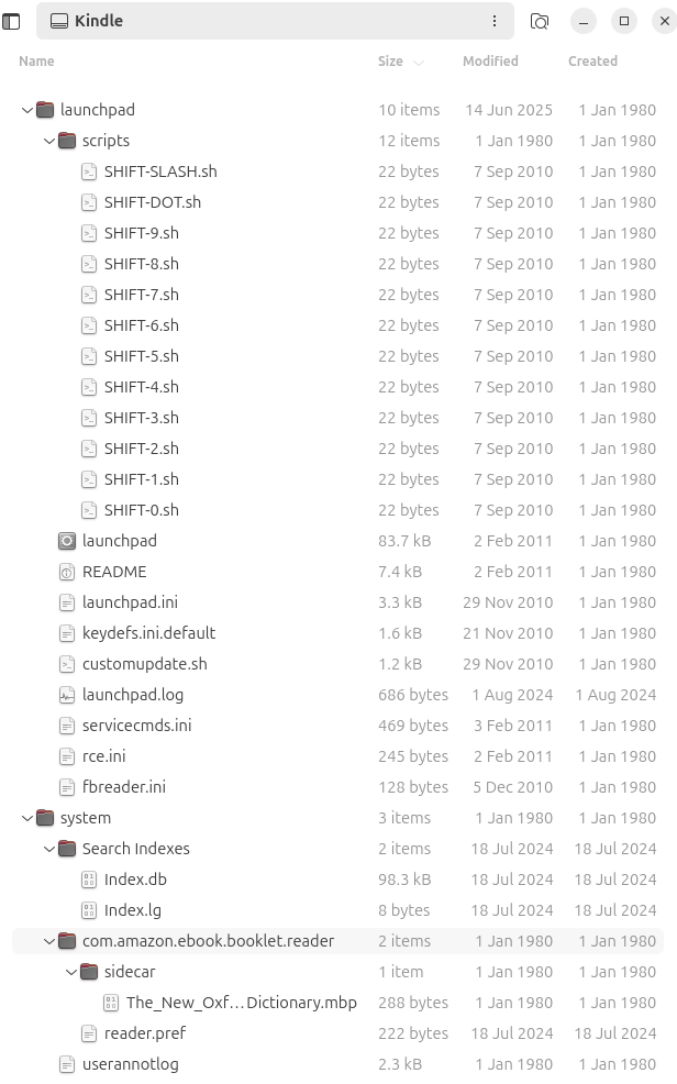

Old 06-29-2025, 03:03 AM   #1404
jjjemp
jjjemp began at the beginning.
Join Date: Jun 2025
Device: Kindle DXG
Hi Spartan-Heavy, sorry for radio silence... looking at kindle-mkk-20141129-r18833.tar it only has a directory called Dev Certs - can you please point me to the MKK installer keystore you mean ...
btw. I installed the update_setdate_B009_dxg.bin via root on the kindle - that's a mistake, no, given what you say above about making sure the clock isn't up to date (screenshots of current dxg file creation/modificaiton dates), but again not so sure how to set the clock without connecting to wifi...
best and many thanks for your generosity and help to all!
Name:	Screenshot from 2025-06-29 16-00-28.png
ID:	216557   Click image for larger version
Name:	Screenshot from 2025-06-29 16-00-46.png
jjjemp is offline   Reply With Quote
Old 06-29-2025, 12:56 PM   #1405
SpartanHeavy
SpartanHeavy has a complete set of Star Wars action figures.SpartanHeavy has a complete set of Star Wars action figures.SpartanHeavy has a complete set of Star Wars action figures.
Posts: 67
Karma: 256
Join Date: Aug 2024
Device: K2 / K4 / PW5
I meant the .bin file. Update_mkk-20141129-dxg-B009_install.bin
Copy it to your Kindle and use the "update your kindle" option. That installs the old keystore on your Kindle.
That file should have set your Kindle's clock to July 2024, which is before the keystore expired.
You can check the clock by entering @time in the search bar on the Kindle.
SpartanHeavy is offline   Reply With Quote
