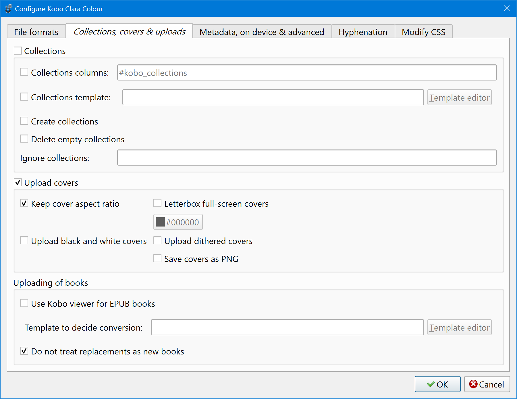

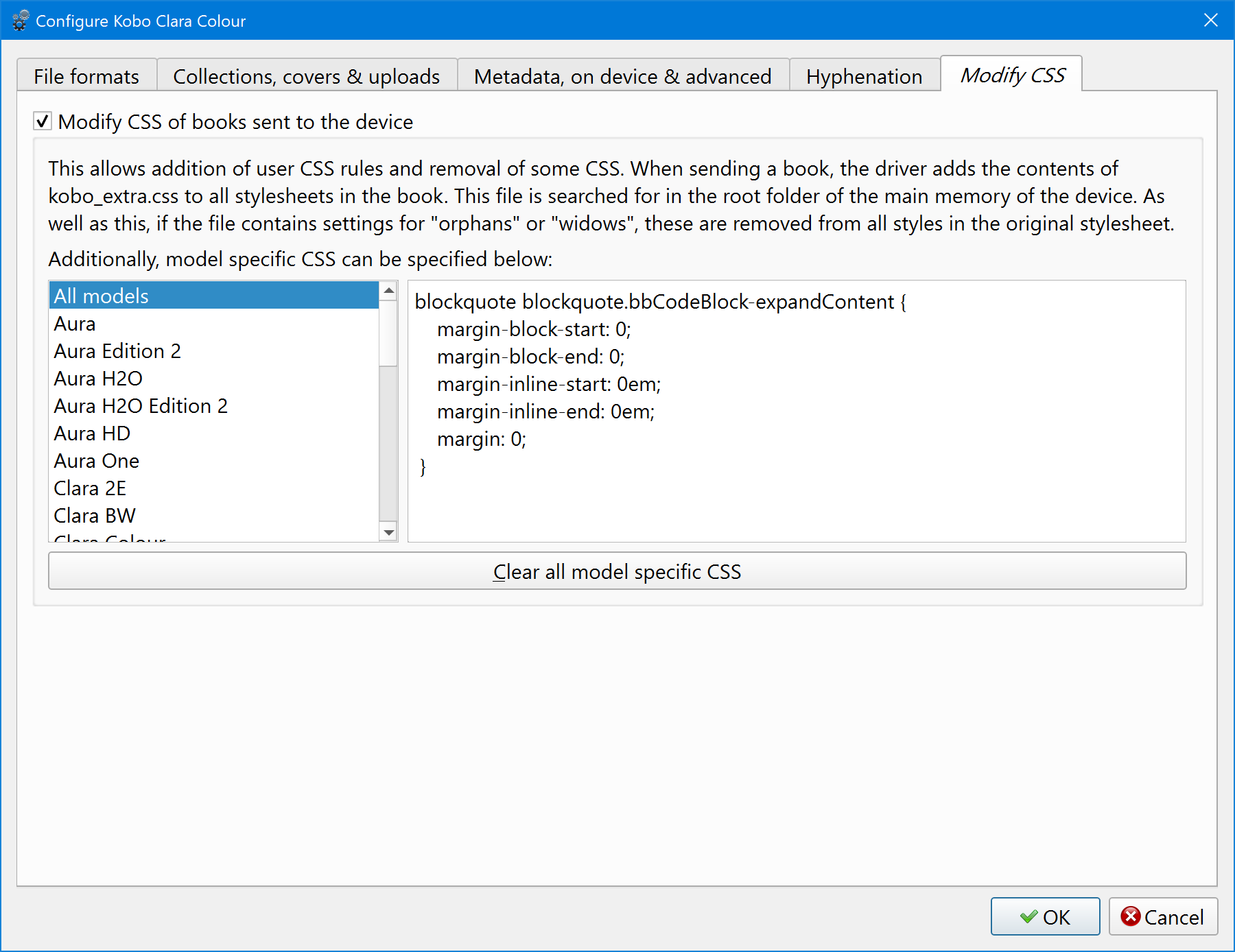

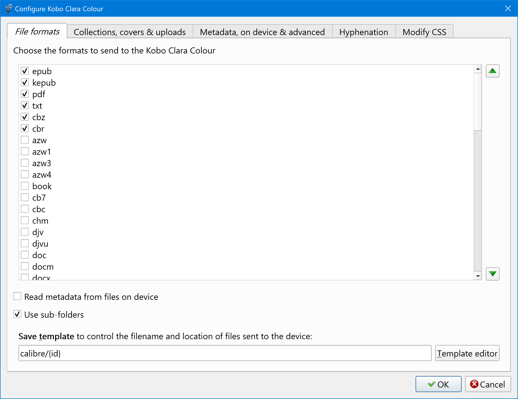

I'm using Calibre 8.4 in Win10 and a new Kobo Clara Colour. I've attached shots of my KoboTouch driver config--I turned off everything I thought would make a difference.
Name:	driver config 1.PNG
ID:	216205   Click image for larger version
Name:	driver config 2.PNG
ID:	216206   Click image for larger version
Name:	driver config 3.PNG
ID:	216207   Click image for larger version
Name:	driver config 4.PNG
ID:	216208   Click image for larger version
Name:	driver config 5.PNG
