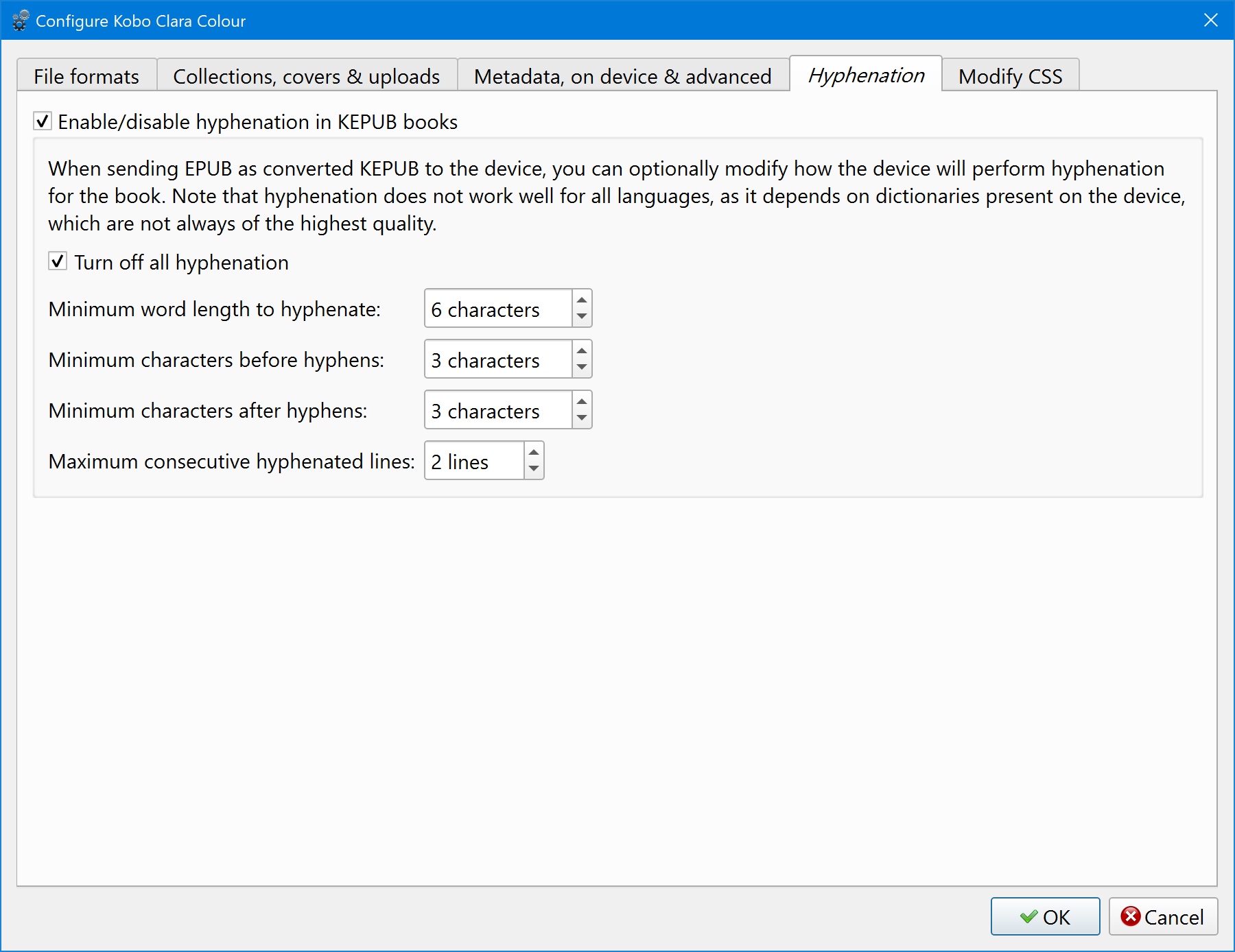

This isn't how I first noticed the issue, but it is the easiest to replicate. Here's what I'm seeing:
  1. Connect Kobo via USB.
  2. Send new epub (not kepub) book from Calibre to Kobo over USB.
  3. Book shows 'Main' in 'On Device' column in Library view.
  4. Quit Calibre -- without disconnecting Kobo.
  5. Start Calibre -- wait for device to be recognized.
  6. Book does NOT shows anything in 'On Device' column, nor in the Device view.
Following these steps, I can get everything back to expected normal:
  1. Send book to Kobo again
  2. Eject Kobo.
  3. Wait for Kobo 'import books' to run and new book to appear in Kobo list.
  4. Reconnect Kobo.
  5. Book does show 'Main' in 'On Device' column and appear in Device view with 'In Library'. Normality achieved.
But wait, I can make it worse! I can instead do (from the end of the first list above):
  1. Eject Kobo without sending book again
  2. Wait for Kobo 'import books' to run and new book to appear in Kobo list
  3. Reconnect Kobo
  4. Book does not shows anything in 'On Device' column. But there is now a book with that name(after plugboard) in the Device view showing nothing for 'In Library'.
Why it matters to me:
Since I'm using KOReader, not the native Kobo app, I'm not running Kobo's import regularly. So new books are on the device, but are invisible to Calibre.
I'm using Calibre 8.4 in Win10 and a new Kobo Clara Colour. I've attached shots of my KoboTouch driver config--I turned off everything I thought would make a difference.
Name:	driver config 1.PNG
ID:	216205   Click image for larger version
Name:	driver config 2.PNG
ID:	216206   Click image for larger version
Name:	driver config 3.PNG
ID:	216207   Click image for larger version
Name:	driver config 4.PNG
ID:	216208   Click image for larger version
Name:	driver config 5.PNG

The failure after the first "step 6" doesn't surprise me. The import must run to fully put the book into the database. I'm not sure what it does, but I think it sets up a UUID and fills in other tables. When you restart calibre without having run the import, calibre's scan might see "wrong" information and might put that wrong information back into the database.
Speculation: your second set of 5 steps fixes that by resetting the database for the book to what it is when the book is first sent. The import (series 2 step 3) sees the new book and does what it needs to do.
Speculation: the third set fails to match the device because the UUID in the database doesn't match anything in the calibre library. Does using "Match book to library" in the device view fix the problem? Matching the book will update the UUID in the kobo database.
You didn't say whether the "normal" sequence works or not, where "normal" is to skip from section 1 step 4 to section 3 step 1. My guess is that it works, as that is what most people do.
I've never used that before, so not sure what it's meant to do.
I clicked it, it didn't find the original automatically, but did present the correct book as the only option when I clicked 'match manually'.
Only difference I see after that is the icon in 'In Library' column in Device view changed.
Sorry, I left that implicit. Normal Kobo native steps: (send, disconn, kobo imports, reconn) work as expected.
I agree that most people will do that, and I acknowledge I've found an edge case, as far as Kobo native users are concerned.
But it does seem to be a problem with using KOReader. I am (perhaps foolishly) trying to use KOReader while still keeping the ability to fall back to Kobo native.
JimmXinu is online now   Reply With Quote
