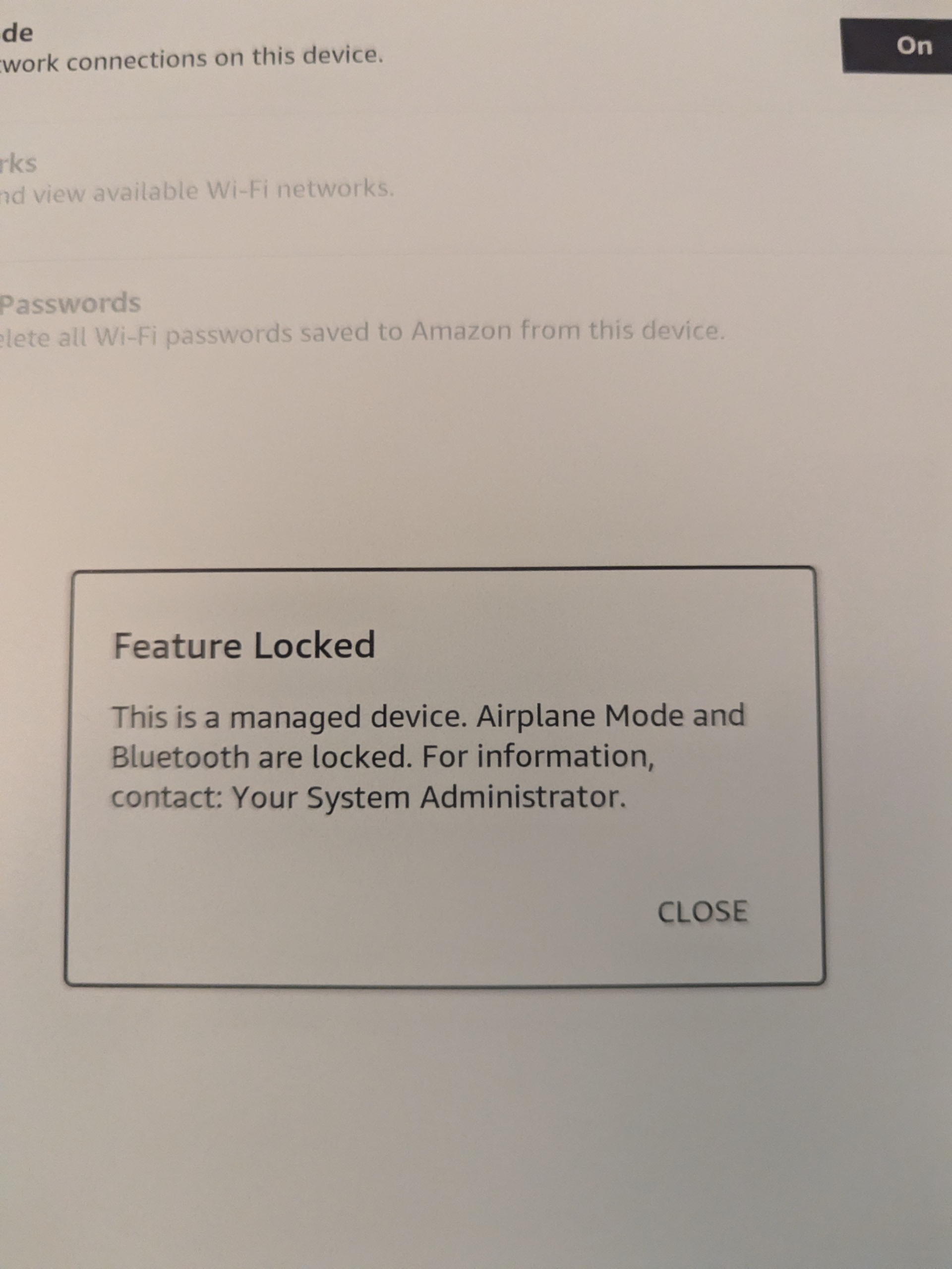

Device: Kindle Scribe
I just discovered that i did the JB in airplane mode and now Im locked out. Any way to unlock it or I have to update to the 5.16.2 fw and start the JB all over again?
Unable to turn on wifi, this is the msg I get
vendo232 is offline   Reply With Quote
You need to install the hotfix
nar001 is offline   Reply With Quote
the fact the WIFI is not working is not an issue perhaps it is a good precausion to avoid update. I`m also reading that the Cloud Register pop up can not be removed, again not an issue once you get to KOreader you don`t really care.
but just to clarify, what hotfix I should install because
I have installed these two:
1. LanguageBreak Hotfix: update_hotfix_languagebreak-{language you want to end up with}.bin
then
2. KUAL hotfix: K5 JailBreak Hotfix | JailBreak-1.16.N-FW-5.x-hotfix.zip | 2024-Apr-21 13:37:00 | 150.2K | when installing KUAL + KOreader
is there any other hotfix I need to install?
You are in "managed mode" you can exit it by following after jailbreak tutorial in languagebreak, the popup CAN be removed but it requires modifying Hermes bytecode (someone has already made a post about it here) as for hotfix questions i recommend nilujes hotfix (2. Here) since it's more up to date.
Marek is offline   Reply With Quote
Thank you Marek!, will give it a try
