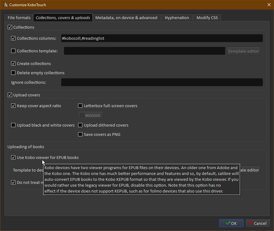

But I want Calibre to convert epub to kepub during send process. What I also want and used to have with KoboTouchExtended was the option "send books as kepubs" which did not save a copy of kepub to my library. Since KoboTouchExtended is deprecated, I have been missing that feature.
It does send books as ePubs with ths option.
Name:	2025-06-05 14_22_33-Customize KoboTouch.png
You need "epub" selected so that Calibre will select it without converting it first. (If kepub is selected, but epub is not, then Calibre will convert it and save the kepub before sending it.)
To get it to convert on the fly, select the "Use KOBO viewer for epub books option" in the Kobo Touch plugin. Then, it will be converted before it is pushed, but will not save the converted file.
bkennelly is offline   Reply With Quote
Old 06-05-2025, 04:23 PM   #168
ddpnc
ddpnc began at the beginning.
Posts: 5
Join Date: Jun 2025
Nice, thank you so much! Didn't even think that "Use Kobo viewer" option is somehow related to what I want.
ddpnc is offline   Reply With Quote

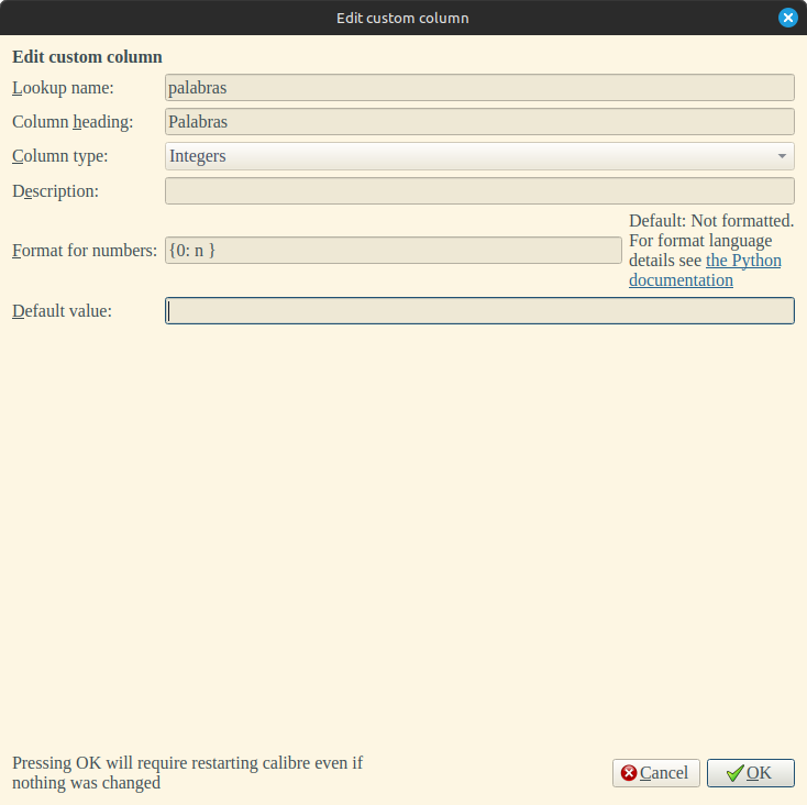

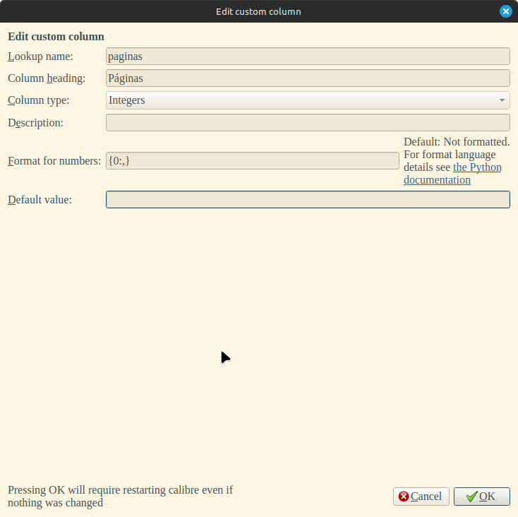

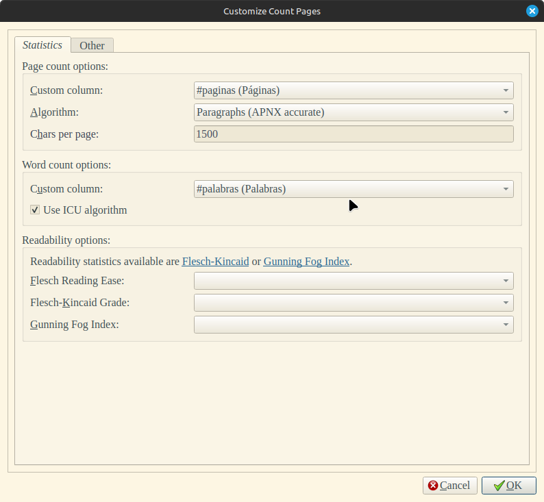

Can someone explain how to set up the page and word number stats in the kobotouch driver? I have the count pages plugin setup to save that data to "# Pages" and "# Words" columns. Do I just click the enable book stats in the kobotouch driver, and type those columns as the template for each?
Lavender is offline   Reply With Quote
Old 06-08-2025, 02:06 PM   #173
dunhill
dunhill's Avatar
Posts: 1,215
Karma: 1513034
Join Date: Sep 2017
Device: moon+ reader, kindle paperwhite, Linux Mint
First, you'll need to create some custom columns. One for the page count and another for the words.
Here are some images and how you should configure the page count plugin.
ID:	216080   Click image for larger version
ID:	216081   Click image for larger version
Name:	config count pages.png
ID:	216082   Click image for larger version
Name:	in screen.png
