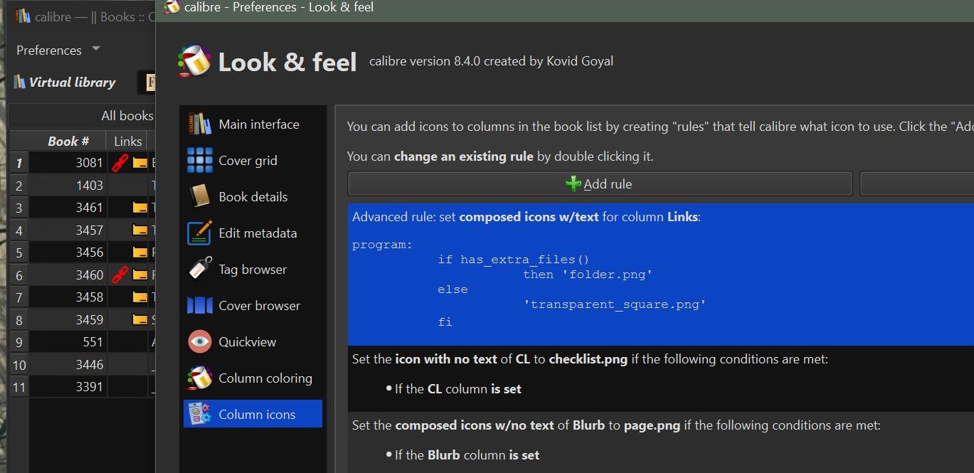

I attach a 'folder' icon to a column (e.g. Title) if has_extra_files() is True.
How? Please describe it in a few words.

No words needed, picture is easier:
Name:	Screenshot 2025-06-02 182216.jpg
Links is a long text column. I attach the folder icon to it because when I store the original file in the 'data' folder I usually put a link to the file in the Links column. Which means I can 'click' on (open) it from the Book details panel - saves having to open and close File System windows.

No words needed, picture is easier: ...
yesssss!
