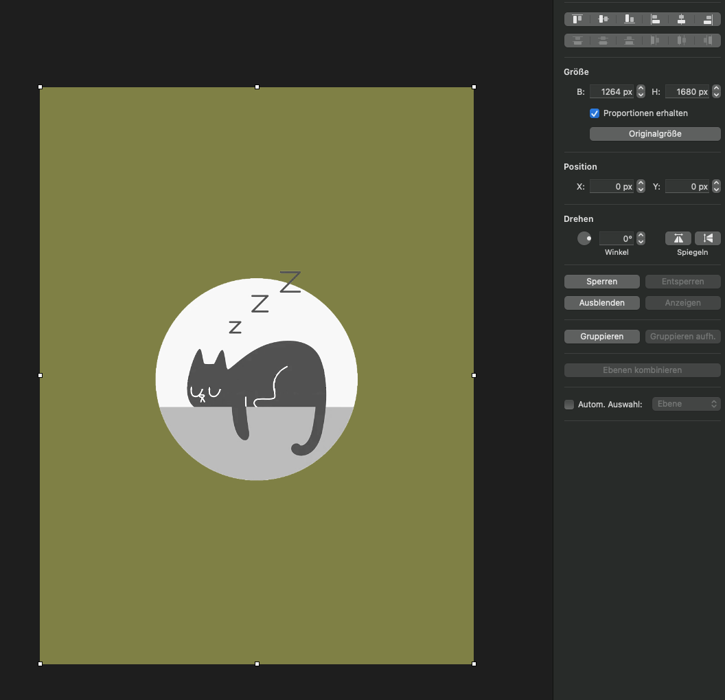

Old 05-31-2025, 08:54 AM   #36
Tintenfisch
Tintenfisch can extract oil from cheeseTintenfisch can extract oil from cheeseTintenfisch can extract oil from cheeseTintenfisch can extract oil from cheeseTintenfisch can extract oil from cheeseTintenfisch can extract oil from cheeseTintenfisch can extract oil from cheeseTintenfisch can extract oil from cheese
Tintenfisch's Avatar
Posts: 14
Karma: 1010
Join Date: May 2025
Location: East Germany
Device: PocketBook Era (b/w) or Kobo Libra 2?
Did anyone get it to work on the newest Software? (Pocketbook Era). It does not work with newest update?
I did the files with
    • right dimensions 1264 x 1680 px (and reverse for landscape)
    • right background color #808040
    • 24 bit saved as BMP
    • saved horizontal + landscape in the right names & folders (see screenshot)
Still it shows the stock sleep image?
See screenshot:

Just tried, works here on FW U700.6.8.4183.
Since we have so few "ready-made" images, I’m adding the one I currently use on my Pocketbook Era, a sleeping cat.
@Tintenfisch: Would you share your sleeping cat? I quite like that, too.
Re your question: Didn’t try 24-bit, I saved mine as indexed 16-color, this reduces filesize from 6.4 MB to 1.1 MB.
taskmgr_lock_background.bmp: PC bitmap, Windows 98/2000 and newer format, 1264 x 1680 x 4, cbSize 1061962, bits offset 202
