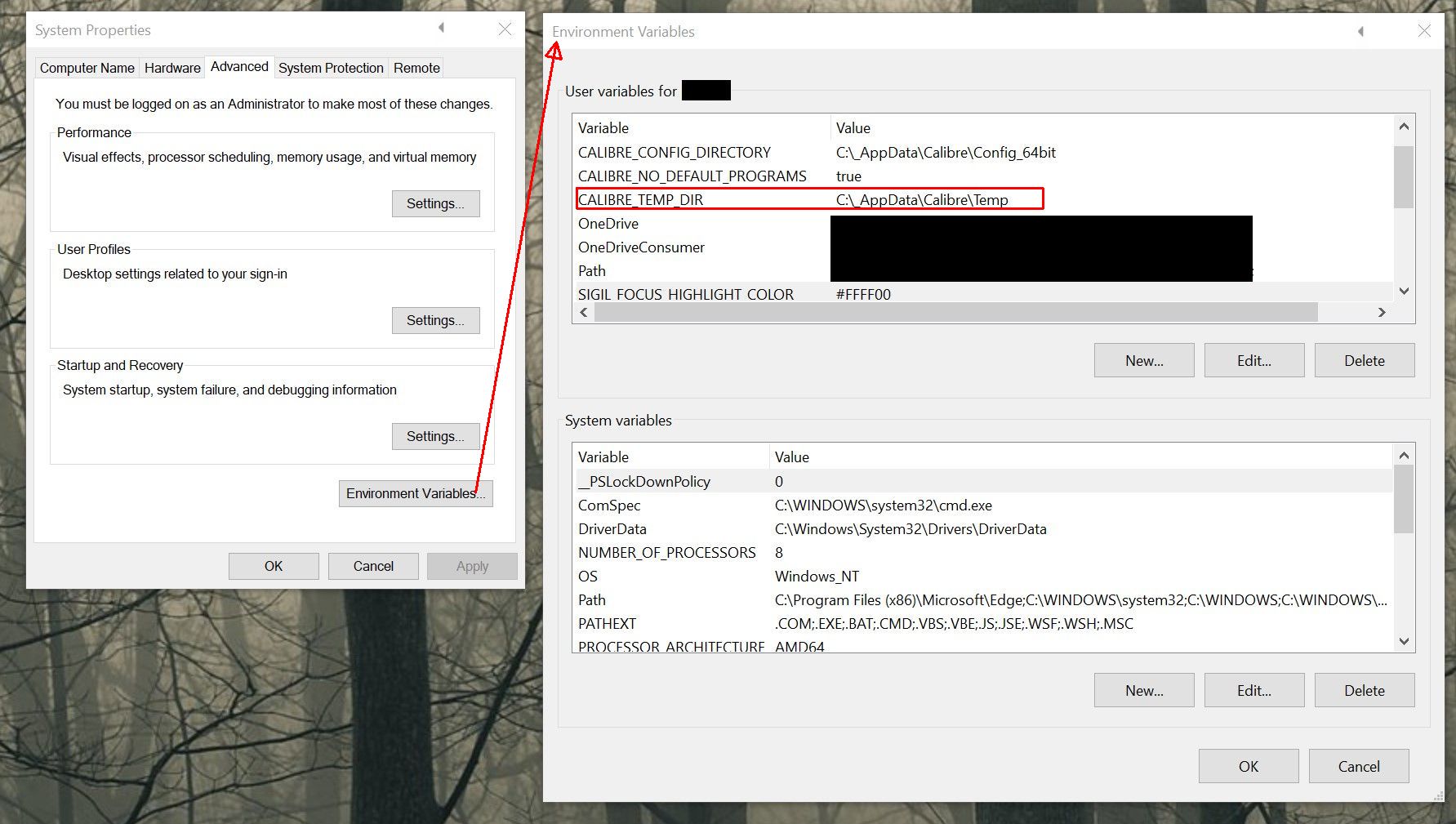

Thanks BetterRed I'm a bit confused though - Running windows, do I just put
CALIBRE_TEMP_DIR = C:\!Calibre\Temp
in the windows list of paths? Or do I need to make some changes in the calibre program itself?

Search for "Advanced system settings" (or Settings->System->About->Advanced system settings (it's on the right)) and then:
Name:	Screenshot 2025-05-31 075446.jpg
Attachment 215933
It would be better (IMHO) to help the OP sort out his permission error is in the system's temp directory.
Attachment 215933
Thanks BR - sorry for the delay in responding - Mobile Read isn't loading for me in chrome for some reason...
I made the change you recommended and it (sort of) worked. The catalogue function in Calibre managed to run without the error message popping up, but then the next time I tried to run calibre it wouldn't load until I reversed the changes.
Am I correct (and please chip in here @JSWolf) in assuming that this is a windows problem rather than a calibre problem?
