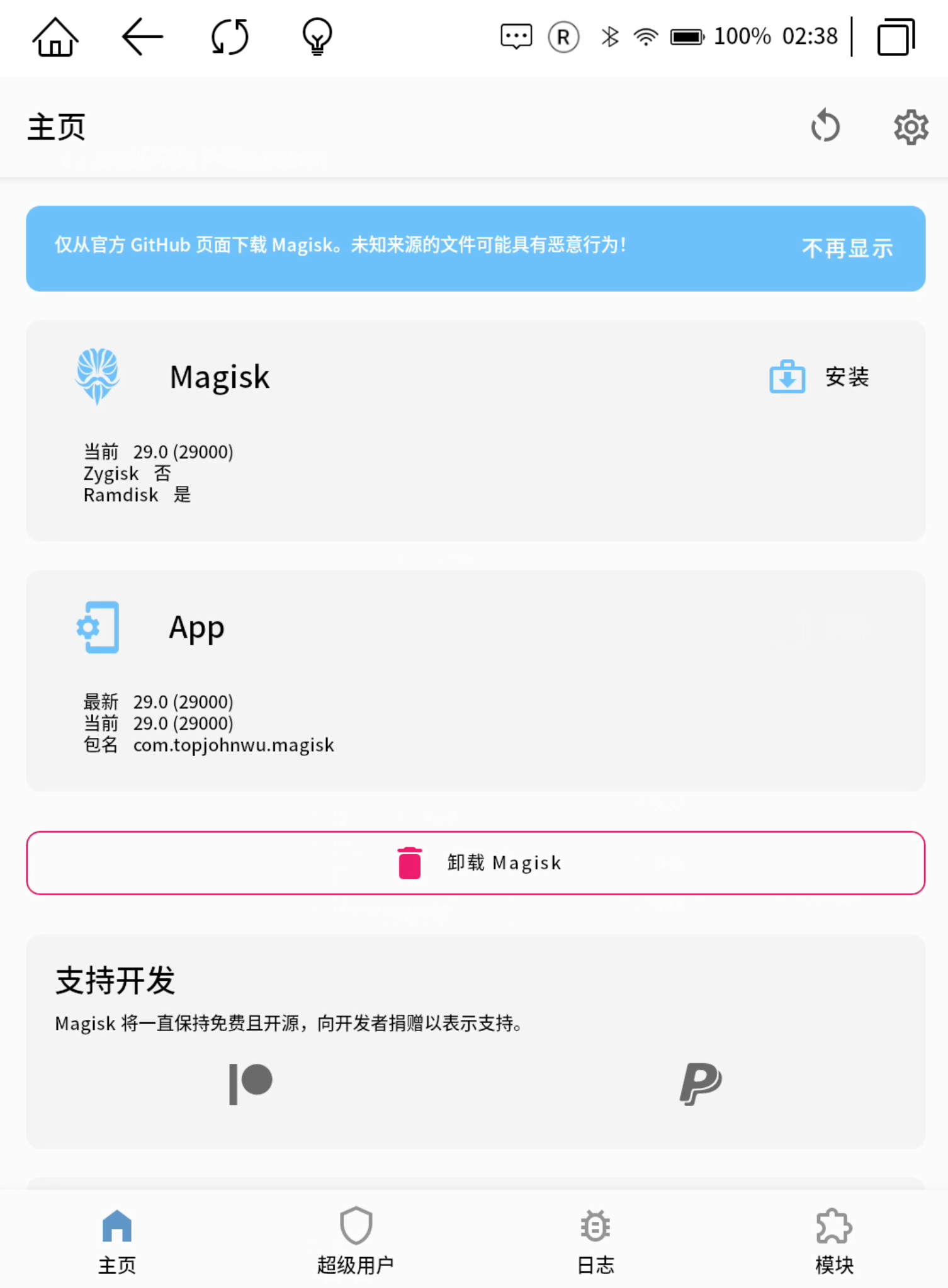

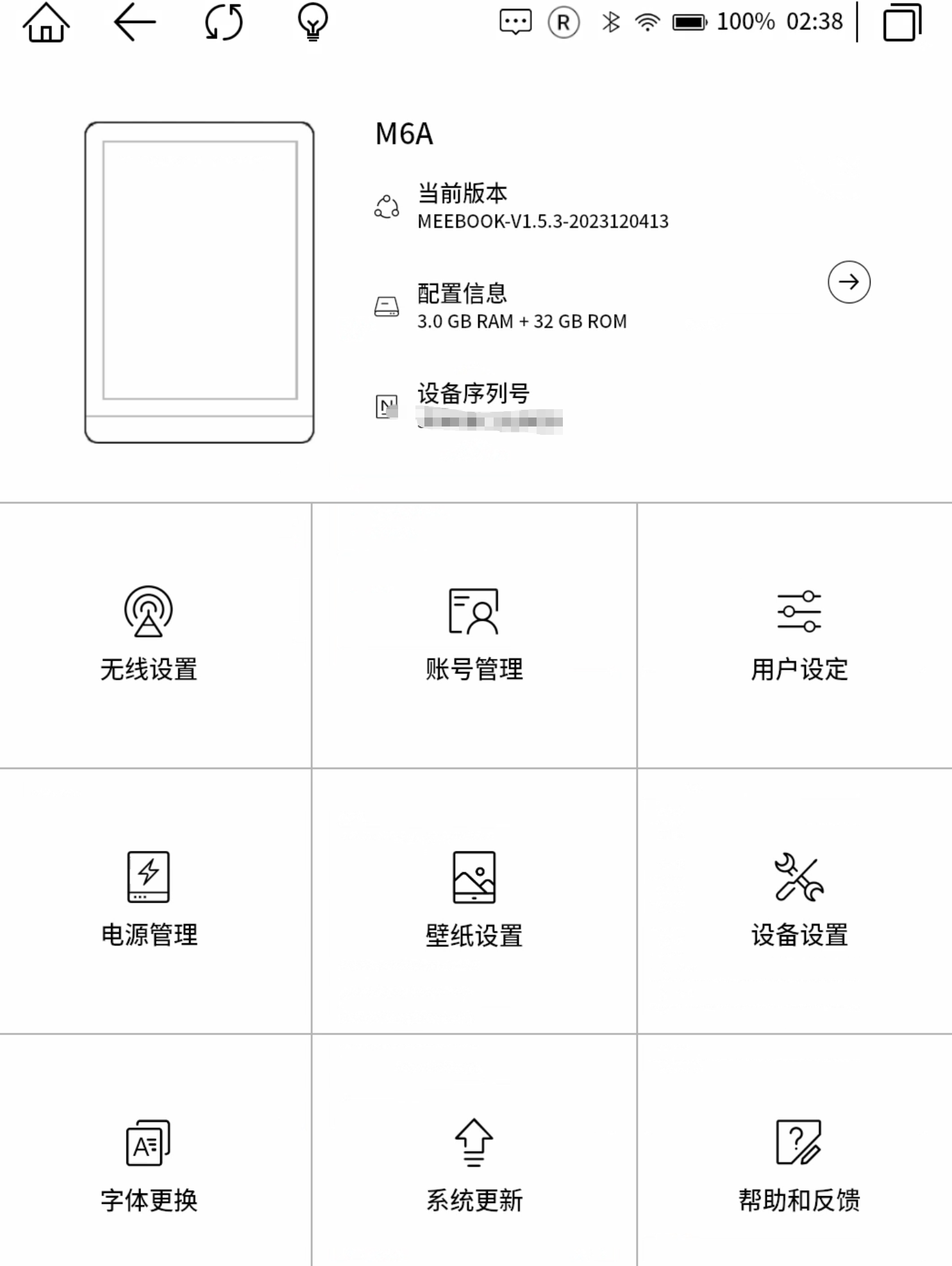

Originally Posted by nsking View Post
I have a Meebook M6A, and I have successfully rooted it.
Like many of you, this device does not have the "OEM Unlock" option in the Settings - Developer Options. However, when I checked using adb shell with the command "getprop | grep lock", I found that the value of "ro.oem_unlock_supported" is "1" on this device. Hence, I believe the OEM unlock is actually enabled. Following this, I used adb reboot bootloader and then entered the fastboot flashing unlock command to successfully unlock the device.
Next, I attempted to sideload a userdebug mode GSI (i use "andyyan-gsi") using the "dsu sideload" tool, but it didn't work as the device got stuck at the logo during boot. However, I noticed that the device was still accessible via adb. I discovered that the adb shell could switch to root using su -. This indicated that the GSI was successfully flashed, but some customizations from the manufacturer prevented it from taking control of the display.
Afterwards, I reinserted the TF card to get it recognized (on my device, its name is mmcblk0p1, and you need to manually mount it to an empty directory). Then, I used "dd if=/dev/block/mmcblk2 | gzip -c > /xxx/xxx/xxx.img.gz" to back up the entire eMMC to the memory card and "dd if=/dev/block/by-name/boot_a of=/xxx/xxx/xxx.img.gz" to back up the boot partition. The next steps were straightforward: use Magisk to patch the boot image and flash it (note the fastboot a/b slot). The first boot after flashing will be slow, so just wait patiently.
###I cant speak english very well,, so the above content was translated from Chinese by GPT. Thank you for your understanding.

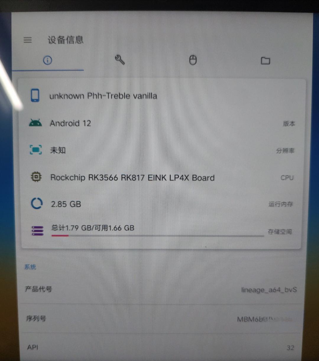

Confirmed, on the Meebook M6, the system image can be obtained by sideloading the GSI image on the DSU.
Package lineage-19.1-20250118-UNOFFICIAL-a64_bvS.img.gz from Andy Yan is available. Remember to back up the entire eMMC data first.
It should be noted that Meebook M6 does not support temporary boot using " fastboot boot <boot.img> " commands. also, adb on recovery is broken.
