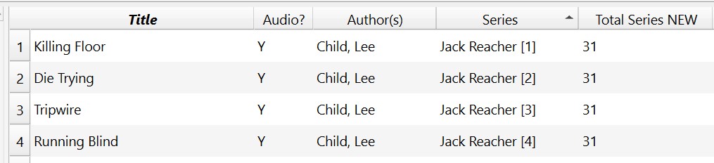

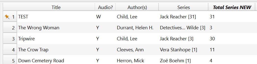

I use Reading List and Calibre Companion (v5.4.4.19) to send the details of the books I want to read this year to my mobile. When reading a book in a series, I like to know whereabouts in the series the book fits, e.g. if I am reading The Head Case by Bill Rogers, I can tell it is book 2 in a series of 14 (see screenshot attached).
To do this I have created a custom column (Total Series) that I manually update with the number of the latest book I have in calibre. Whenever a new book in a series is released, I bulk edit all the books in that series. This then updates another custom column (Series Pos), which is sent to Calibre Companion.
However, I wonder if the Total Series column could be automatically populated by calibre, perhaps by using Template/Search Template or a plug-in. My knowledge of templates is basic at best and would appreciate some help on this.
I know calibre can already calculate the next index in a series when adding a new book and I have seen reference to “get_next_series_num_for” in the calibre support (https://manual.calibre-ebook.com/db_api.html), but I cannot figure out how to call the code from a custom column.
Can anyone point me in the right direction, please?

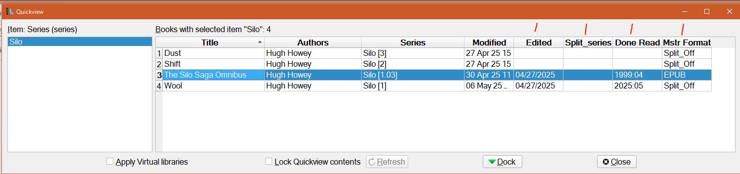

Originally Posted by DJH352 View Post
I'd be happy with that. I don't think Goodreads, Fantastic Fiction plug-ins look for that information.
Those Plugins fetch metadata from the WWW. I don't even think those sites can even know what the Max number of books in a series is (it is a jumble, if you ever visit the Author page. Some appear in 2 (bridge series), Some books in a series are not even numbered (or are now Omnibus editions). Some get renumbered or even renamed .
IMHO don't bother bloating your metadata with extra columns that may be wrong next random period.
Quickview (built in). Place the cursor on the Series name for a book you are interested in: Tap 'Q' That shows all the members IN YOUR LIBRARY Metadata (I sometimes add 'empty books' to track /wishlist )
I added some of MY custom columns to the Quicview VIEW (red marks) to make deciding easier . (As you use Calibre, you will discover the amazing amount a flexibility in its design)
BTW Quickview can respect the current VL
(not done here).
#Split_series is for when they do bridge (and no PI or site is going to make this obvious) #Split off is when I used EPUB-Split PI to break up a Boxed set) #Done Read 1999 is a flag that I have split this item. All these customs are Manual data entry. There is no Auto fill .

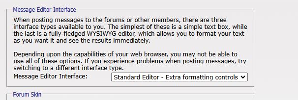

Can anyone tell me how you get the 'originally posted by ..." on your replies?
All tags in MR need to be closed
Your post had the Opening [quote] but appeared to be missing the closing one
BTW I use the advanced message editor (by default. ) The Quote icon is the speech balloon usually found in comics)
EDIT
attached is the setting screen for the MR editor

This is fantastic, thank you so much.
I added an empty book to the Jack Reacher series and calibre immediately populated the column for that book with the maximum index number. There was no lag (1,350 books)
After a re-start all books in the series were updated. When I deleted the empty book and restarted calibre, the field automatically updated again
Thank you to everyone who has help me with my query
