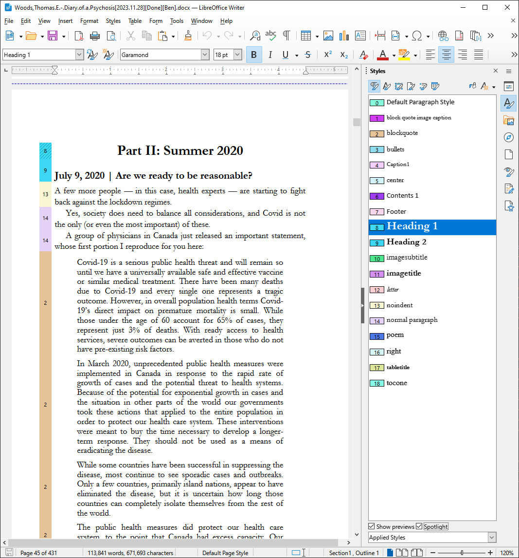

Side Note: And, make sure you're on the latest LibreOffice 7.6.
They added this really fantastic "Styles Highlighter" feature called "Spotlight":
ID:	205389 Click image for larger version
You get to it by:
  • View > Styles (F11)
  • Alllll the way in the bottom right, you should see a little checkbox called "Spotlight".
After turning it on, it numbers/colors all the Styles currently used in your document. This easily lets you see+tag+clean them up.
It was first described back in 2019 in this blog post:
and finally made it into LibreOffice in 2023.
