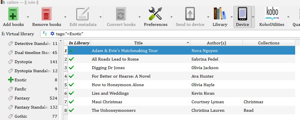

The past days (I don't know how many, maybe since the last day's update), it doesn't update the tags. It just says "Books updated=0".
I have decided to change up my tags and about 300 aren't updated.
It does update changes in summary.
It's something weird, because the new tags are visible in the Device Tags in Calibre, and they show books in them. But the books themselves aren't shelved in the device (see in the attached image).
I have tried uninstalling and installing KU, disconnecting and reconnecting the KL2, powering it off and on. The Automatic Management of Calibre in enabled, but I don't think that it has ever worked. I have NickelMenu installed for months.

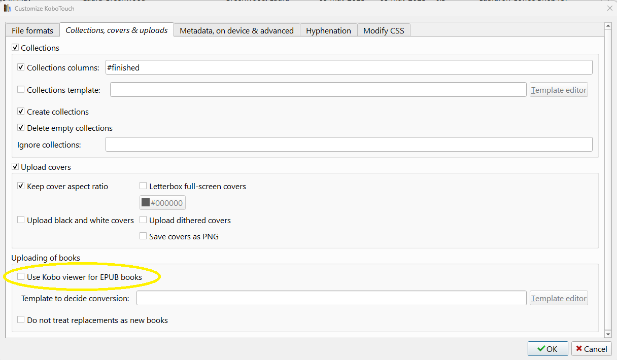

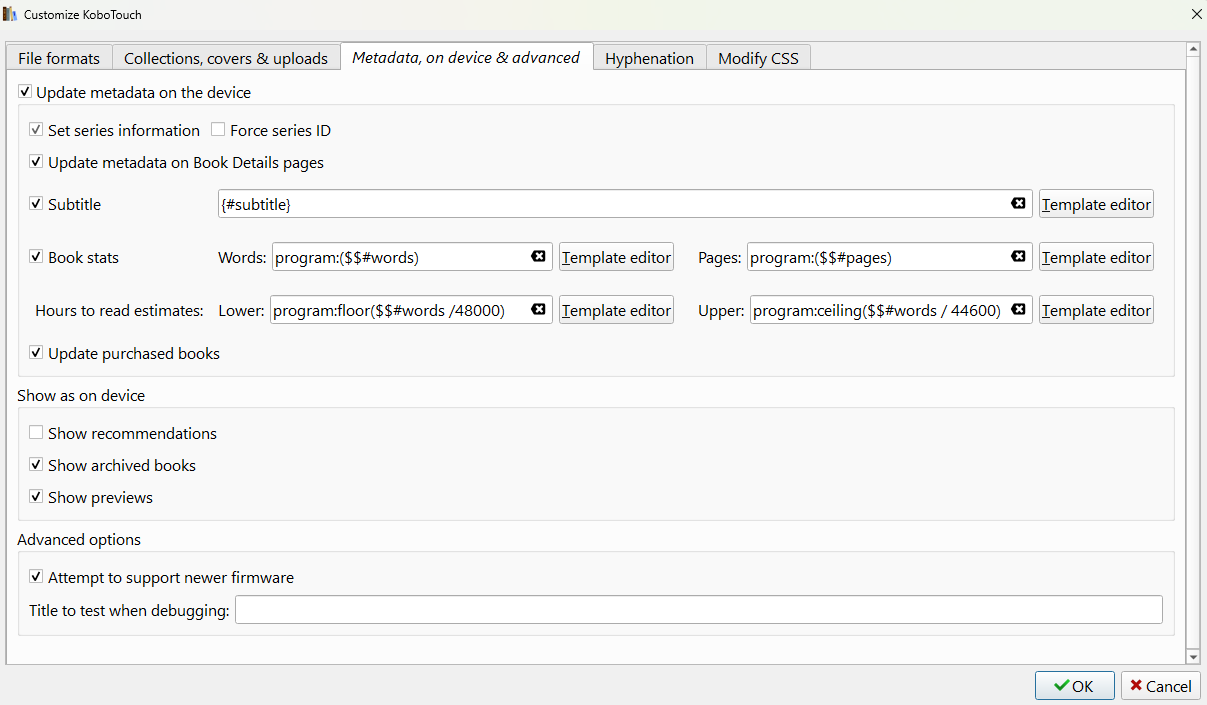

What @PeterT said. The reason for looking at those files is to allow you to see what your configuration was. As for automatic metadata management? It has always worked for me. I've attached a set of screenshots of my setup. The User Kobo viewer for EPUB books is checked to convert to .kepub.epub on the fly.
