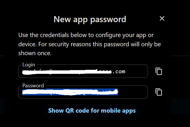

I am having trouble getting Nextcloud (free shared hosting provide setup via Nextcloud's website) setup
The attachments show the app password from nextcloud and my attempt to enter that info into KOReader. I copied the login details and pasted into Notepadd++ then into the reader settings.lua on my KOReader to avoid typos.
The error message in the crash log is
WARN Error fetching existing notes from Nextcloud Server HTTP response code is not OK
I tried modifying the URL to
https://tio.lv.tab.digital/apps
but that made no difference to the result. What am I doing wrong?

I saw your message on the other thread. Unlikely to receive support here, too.
For many reasons:
- it is currently broken, see:
https://github.com/koreader/koreader/issues/13623
- Instructions in https://github.com/koreader/koreader...extcloud-notes are not end user friendly yet. They assume you're confortable with nextcloud, understand the app infrastructure within nextcloud and the user have installed and enabled the relevant application, called "notes"
Fixing all this is high on my to-do list but I don't want to mess up with my main nextcloud instance, so I'll need to fire up a temporary nextcloud instance somewhere and test agaisnt it.
I'll post here when the issues are addressed so you can retry again.
