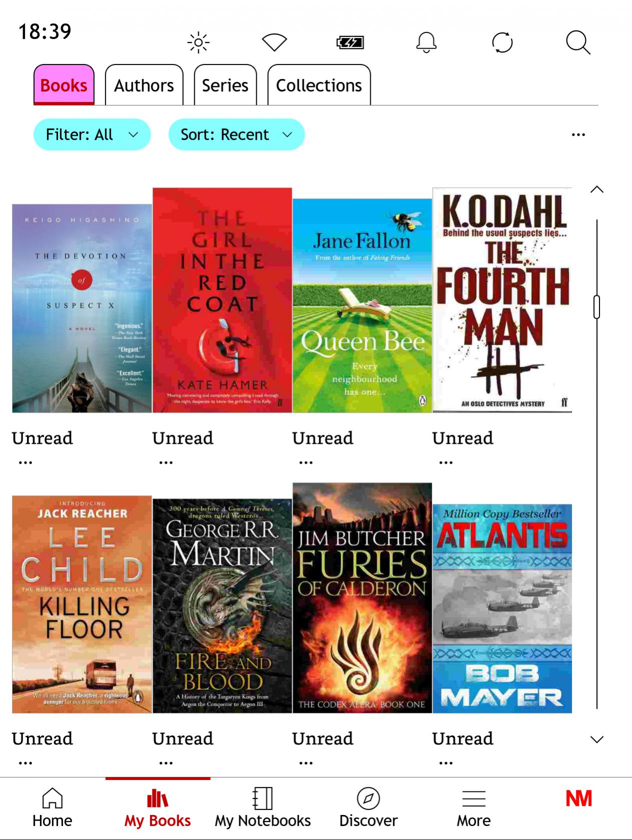

Does anyone know if a patch exists to increase the size of thumbnails in cover view on the Kobo Libra Color?
Ideally I want to see 6 covers rather than 8 on a single screen so that each cover is larger (similar to the Kindles).
Am on the latest firmware 4.41.23145.
I don't think you can change the 2x4 thumbnail grid in Cover view to 2x3. The best you could hope for is something like the attached image, which minimises the horizontal gap between covers to almost zero.

Join Date: Jun 2019
You guys are missing the point.
I patched and I have no such options. There is no "Extra" nor is there "Activity". When I long-press a word, I can add it to "My Words", that is, I do see the "Add to my words" button. However, I have no way of seeing a list of previously added words. And this is a patch thing.
All I see when I go to the "More" tab is "Settings" and "Help".
I tried adding "MyWords=true" to the config file but nothing changed. I still can't find my words anywhere. What I want is a way to access my words!
doki43 is offline   Reply With Quote
Old 05-01-2025, 04:54 AM   #1260
Sirtel
Sirtel's Avatar
Posts: 15,519
Karma: 248046301
Join Date: Jan 2014
Location: Estonia
Device: Kobo Sage & Libra 2
No idea what you patched, but I also patch and Activity is definitely still there.
