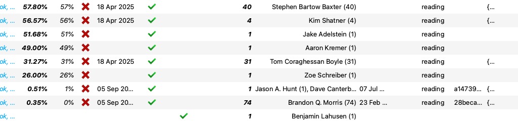

Hi, is there a way to schedule or add a feature to set an amount of time to update "Sync from ProgressSync", I know technically the daily ProgressSync does this, but it does it on an hourly basis (military time) example: if I put 0:15 it translates to 12:15 am specifically, what I want is for it to update every 15min or every 30 min
edit:
also, once i finish reading a book it keeps showing in the update window
Edit #2: I already figured out de ProgressSync part

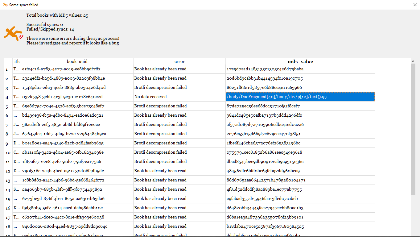

I'm having an issue with ProgressSync. Having messed about with this for weeks without making any progress, I am clearly not smart enough to work this. Everything is set up correctly, as far as I can tell, but it will not sync progress through progress sync. When I click "Sync from Progress Sync" and when it's done, a new window pops up with a man falling over and the heading "some syncs failed." For books with some percentage read, I only ever get "Brotli Decompression Failed." How do I fix this?
I'm using the most recent version of the plugin from Git Hub with Calibre version 8.5 on a Windows 10 machine.
On an unrelated and minor note, I have a tiny screen laptop and my resolution is set to max, but the window that pops up when I sync does not fit in the screen and you cannot resize it. When I try to resize, it disappears completely. I don't even know if there are buttons at the bottom of the window.
I've attached a screenshot of what I get when I click Sync from ProgressSync

I'm not a KoReader user but snooping around the repositories for KoReader and the ProgressSync plugin it would appear that brotli support has been removed, but a release of the plugin including that change has not occurred.
The last release was on April 30th; the change to remove brotli was on May 19th.
Yeah. I tried replacing action.py in the downloaded zip file with the newer version without brotli and I got a slew of additional errors regarding "percentage" and "TypeError: '>' not supported between instances of 'int' and 'NoneType" and then when I restarted Calibre the plugin was installed but the menu options were gone. I'm beginning to think this is just not for me.

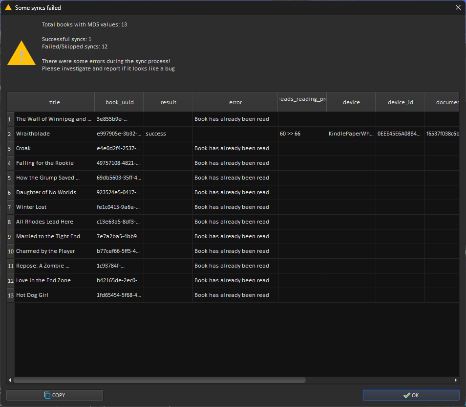

There is a little problem with the sync:
calibre, version 8.10.0
FEHLER: Unbehandelter Ausnahmefehler: <b>KeyError</b>:'summary'
calibre 8.10  embedded-python: True
macOS-15.6.1-x86_64-i386-64bit Darwin ('64bit', '')
('Darwin', '24.6.0', 'Darwin Kernel Version 24.6.0: Mon Jul 14 11:28:17 PDT 2025; root:xnu-11417.140.69~1/RELEASE_X86_64')
Python 3.11.12
OSX: ('15.6.1', ('', '', ''), 'x86_64')
Interface language: de
EXE path: /Applications/calibre.app/Contents/MacOS/calibre
Successfully initialized third party plugins: Gather KFX-ZIP (from KFX Input) (2, 26, 2) && DeDRM (10, 0, 9) && Package KFX (from KFX Input) (2, 26, 2) && Amazon.com Multiple Countries (1, 0, 0) && Apple Books covers (1, 1, 0) && Author Book Count (2, 2, 3) && Author Book Count Hierarchy (1, 2, 6) && Backup Configuration Folder (1, 1, 2) && CalibreSpy (1, 0, 92) && Clean Metadata (0, 0, 6) && DNB_DE (3, 2, 5) && EpubCheck (0, 2, 6) && Extract ISBN (1, 6, 5) && Find Duplicates (1, 10, 9) && Job Spy (1, 0, 239) && KFX metadata reader (from KFX Input) (2, 26, 2) && From KFX (2, 26, 2) && KFX Input (2, 26, 2) && KOReader Sync (0, 7, 2) && KindleUnpack - The Plugin (0, 83, 8) && Last Modified (0, 8, 5) && Manage Series (1, 5, 2) && Mass Search-Replace (1, 8, 2) && Modify ePub (1, 8, 6) && Open With (1, 8, 4) && PocketBook Improved Device Interface (1, 0, 4) && Pocketbook Tools (0, 10, 0) && Quality Check (1, 14, 2) && Reading List (1, 15, 6) && Reformat plugin (2, 4, 0) && Resize Cover (1, 2, 1) && SF-Leihbuch (1, 0, 1) && Save Virtual Libraries To Column (2, 0, 1) && Save Virtual Libraries To Column GUI (2, 3, 0) && Search The Internet (1, 11, 3) && Standard Ebooks (1, 0, 0) && ePub Extended Metadata {Writer} (0, 11, 4) && ePub Extended Metadata {Reader} (0, 11, 4) && ePub Extended Metadata (0, 11, 4)
  File "calibre_plugins.koreader.action", line 1155, in run
    if metadata.get(target) is None and sidecar_contents['summary']['status'] == 'reading':
KeyError: 'summary'
The problem is when that error drops out, the whole process stops and the only way to get back a functionable calibre is to force-quit and restart calibre.
I found out when there is a book with reading status (y/n), but without the reading status (text) set to reading, it stopped syncing. So after setting the text value manually to reading, sync was successful.
But now, it seems to be another problem. Maybe because there is no sidecar on some books? That books i had started reading (and stopped a while ago) never got a sidecar.
It would be nice if i could see which book is causing the error and if possible, that error should be fixed by koreader sync, if its possible...
koreader sync is 0.7.2
