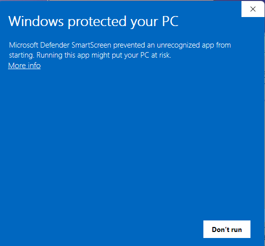

Windows won't let me run k2pdfopt
This frustrates me. Windows has security issues with k2pdfopt, and I can't install the program. What can I do?
Sheesh... the google-fu is running weak.
If you are getting an image like the first one attached, click on More info and then click on Run anyway. What this is telling you is that there have not been enough installs for Microsoft to say the app is in common use.
Name:	Screenshot 2025-04-24 170144.png
ID:	215254   Click image for larger version
Name:	Screenshot 2025-04-24 170204.png

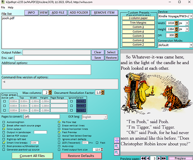

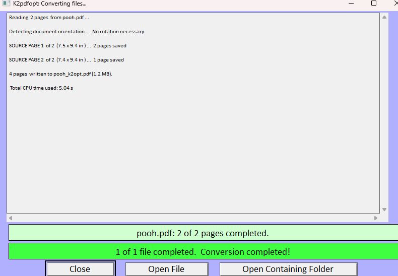

What you describe does not sound like k2pdfopt for Windows. Are you sure you're downloading it from the right place? If you save the downloaded file to your desktop or a folder and then double-click it, you should get the Windows GUI window like I've attached. If you do a conversion, you should get a conversion window like I've attached. The whole business of time-stamping the conversion steps and saying "Not all parts appear to be there!"...? That's not even in my code.
ID:	215363   Click image for larger version
