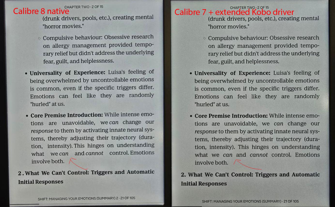

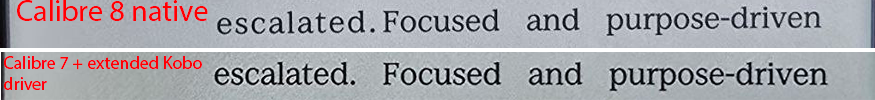

I downgraded Calibre to 7.26 and used the old way to send the exact same book to my device. Here's the outcome, and a comparison image.
ID:	215189   Click image for larger version
ID:	215190   Click image for larger version

The only difference I can see is there is no space after the period. If converting to KEPUB is removing the sapce in this book, then open a bug report and attach the original book.

Thanks, I will open a bug report as suggested and upload both the original EPUB and the v8 converted KEPUB and the v7 + extended driver converted KEPUB.
The space is still there when I open the .kepub.epub file using Calibre's reader via the Device menu, and it doesn't seem like that's the problem here.

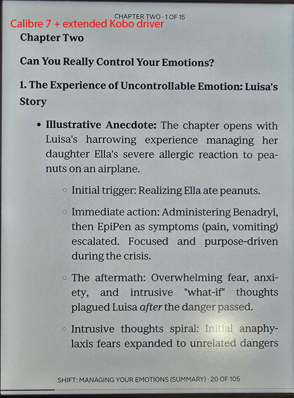

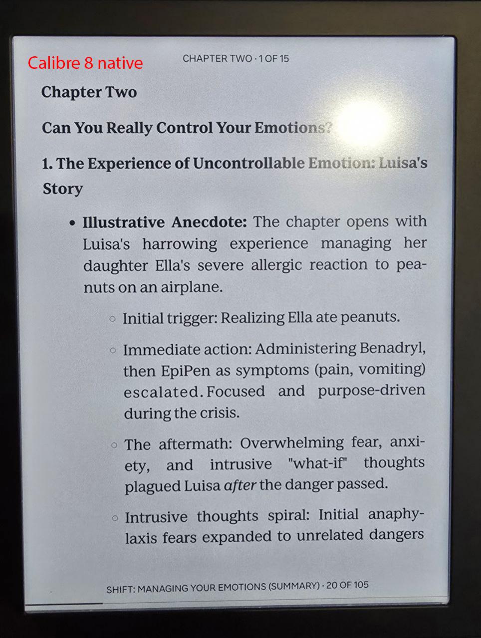

I also got another comparison photo of the two versions.
Update:
Output is confirmed different, but the broken justified text is a consequence of trying to make sure there're no gaps in highlighting, and this won't be fixed
https://bugs.launchpad.net/calibre/+bug/2107778

Checking those pictures, it looks like there is no added space before the dot in v8. Non-break space instead of normal space?
