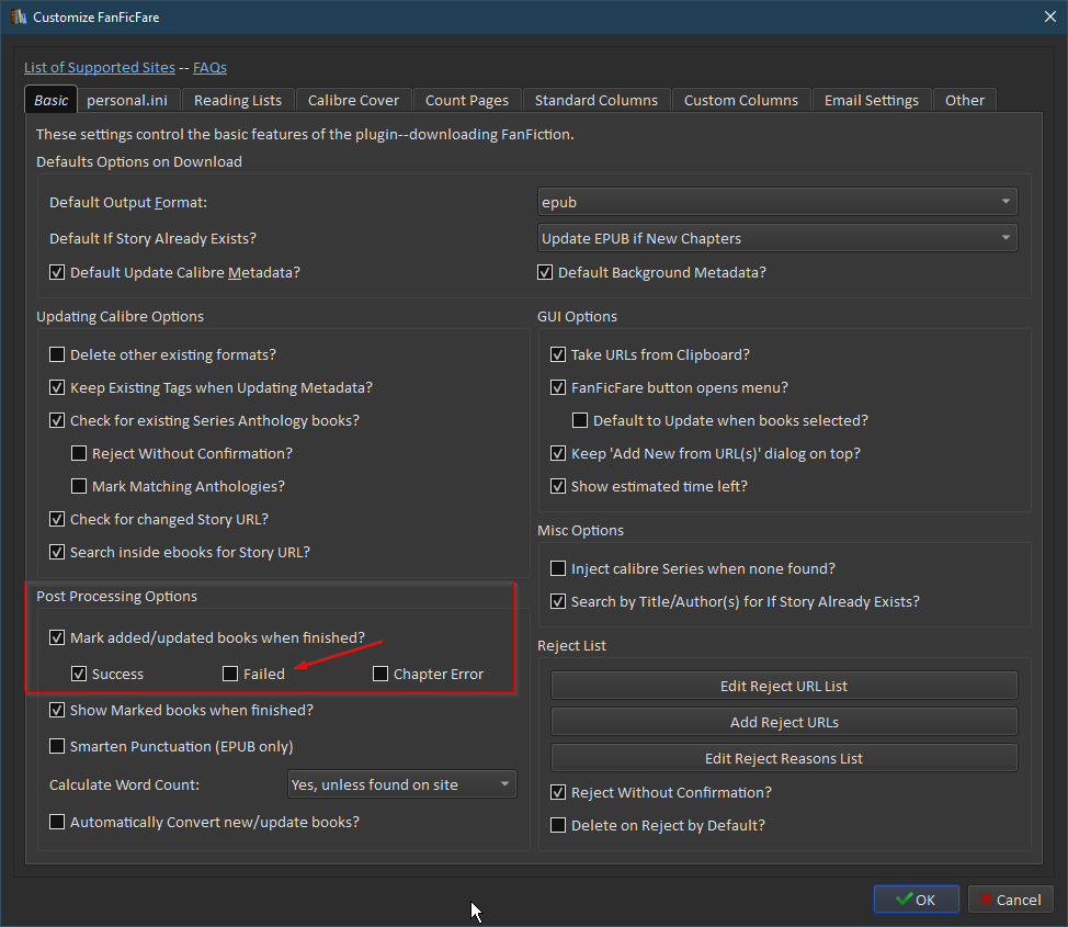

Feature request
Say I list 5 files in FFF to download and after a while get "FFF found 3 good and 2 bad updates". So I click on Proceed, get my 3 good books but which books failed?
Can there be an option, another button say "Write fails to log", where failed downloads with appropriate information get written to a file so can be tried again? Maybe even make that the default for fails and write it right to Calibre?
Name:	2025-04-17 17_57_42-Customize FanFicFare.png
Don't you get a choice to view log? I just had a similar failure (except they all failed) and chose view log, then copy to clipboard, and pasted it all into a document. The log shows the URLs and which of them failed. I'll be extremely glad when Ao3 stops having these problems. Has anyone seen any updates from them about it? Their tumblr hasn't had anything - if they're using the other social media they have listed I can't see it, as I don't have accounts on any of them.

I have that checked but what does it give me?
However I had not checked the "Mark..." check box. Is that what was missing
You can view marked books, and the labels on pins identify failed.
Click View Log in the Proceed dialog before clicking 'Yes' to update library.
Or, open the Jobs list by clicking where it says 'Jobs' in the lower right corner, then double click on the last 'Download X Fanfiction Books' job to see the full log. At the bottom, it will tell you what failed and the log will tell you why.
As pointed out, there's also options to 'mark' both successful and failed books--which admittedly doesn't help with new downloads.
You can create a custom column for those errors if you want to retain them.
On the "Custom Columns" tab, there is a section at the bottom labeled "Special column:" and you want to create a column and add it to "Update/Overwrite Error Column:". I don't check the "Save All Errors" box, so I only see error messages if the last run failed. Granted, stories with no updates are listed as bad but have no error message, so you will only see them if you use the "View Log" button others have mentioned.
I wish that it had Good/Bad/No instead of just Good/Bad, but the current system works.
