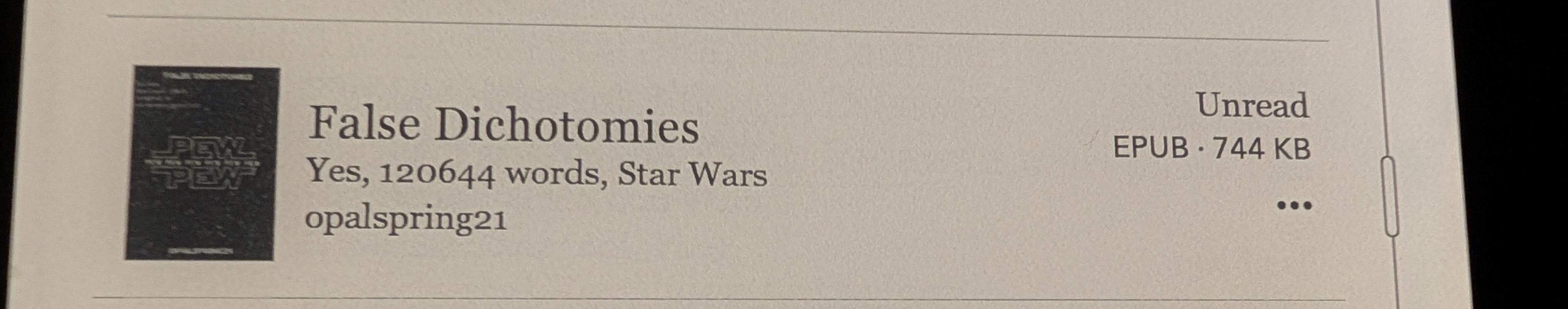

Before I took my involuntary break, I had just set up calibre so that some metadata (word count, collection, whether the story was completed or not) showed on my kobo beneath the title of each story. I've attached a picture of what I mean. I primarily read fanfic using fanficfare so this data being easily visible was super helpful.
Since my mass update, thats stopped happening. I remember I had to do code using the calibre template language but I cant find the setting to do it anywhere. I think it might have been through the Kobo Touch Extender plugin which is gone now, but I'm not sure.

It's the subtitle field in the Kobo driver settings.
The easiest way to access the driver is to install the Kobo Utilities plugin, right-click on it and select Driver -> Configure the driver.
