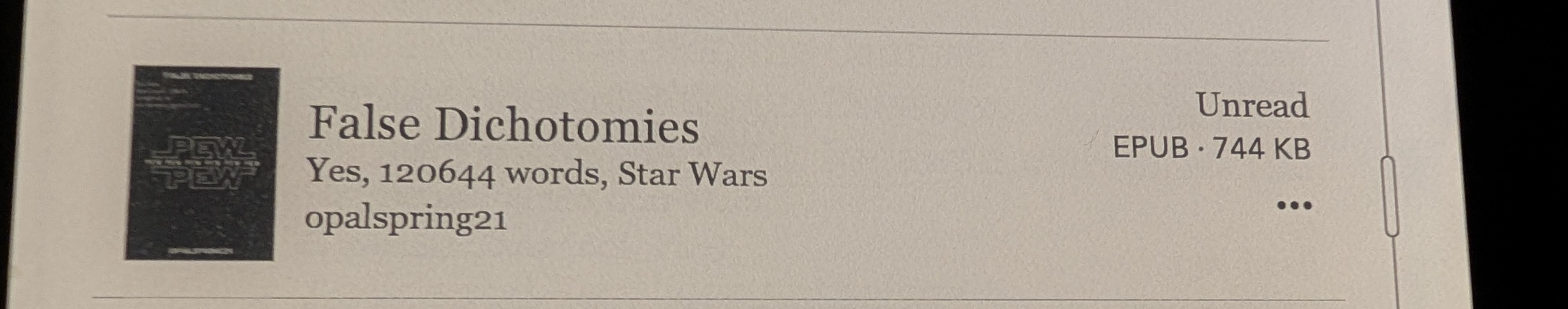

iakrus
iakrus began at the beginning.
Posts: 15
Join Date: Aug 2024
Device: kobo sage
hi!
i havent had access to my computer (and thus my calibre library) for a few months, and i just got it going again. i updated to version 8 and updated all my plugins. I tried to add/update some ao3 fanfics and discovered the issues.
Can someone give me a quick rundown on the problem/solutions?
As a sidenote, I was wondering if anyone knows what plugin allowed me to add metadata under my kobo readers fic titles (as pictured below). That has also broken with the updating of the plugins, presumably because V8 was kobo update heavy? I know this isnt the right thread for this, but I figured I'd try and solve two issues with one post- I'll repost elsewhere if no one here knows!
thanks!
iakrus is offline   Reply With Quote
