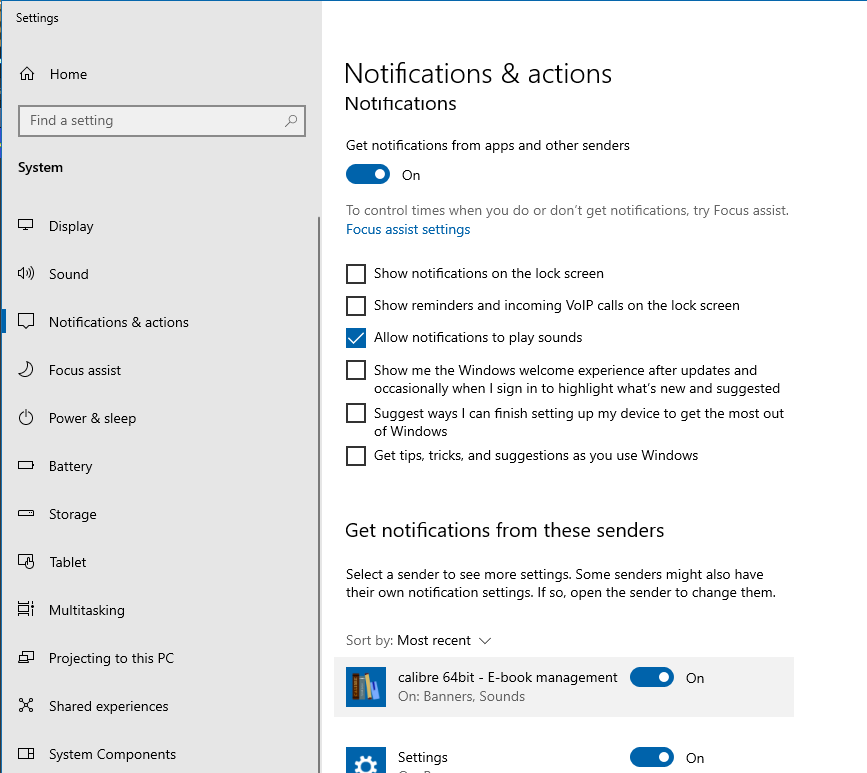

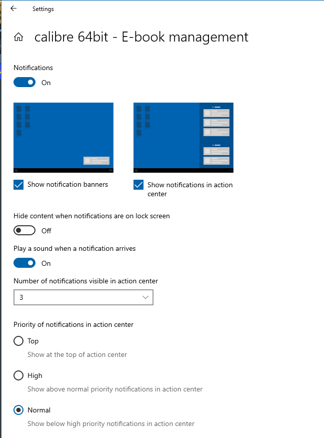

@Karellen, I forgot to ask you to take a look at your notification settings, i have set them like this on Win 10 (I know you're on Win11 but it should be similar):
Name:	MWSnap 2025-04-04, 17_14_03.png
ID:	214848   Click image for larger version
Name:	MWSnap 2025-04-04, 17_13_55.png
Thanks. I've adjusted these settings. I'll see if that works.
Yep that works!!

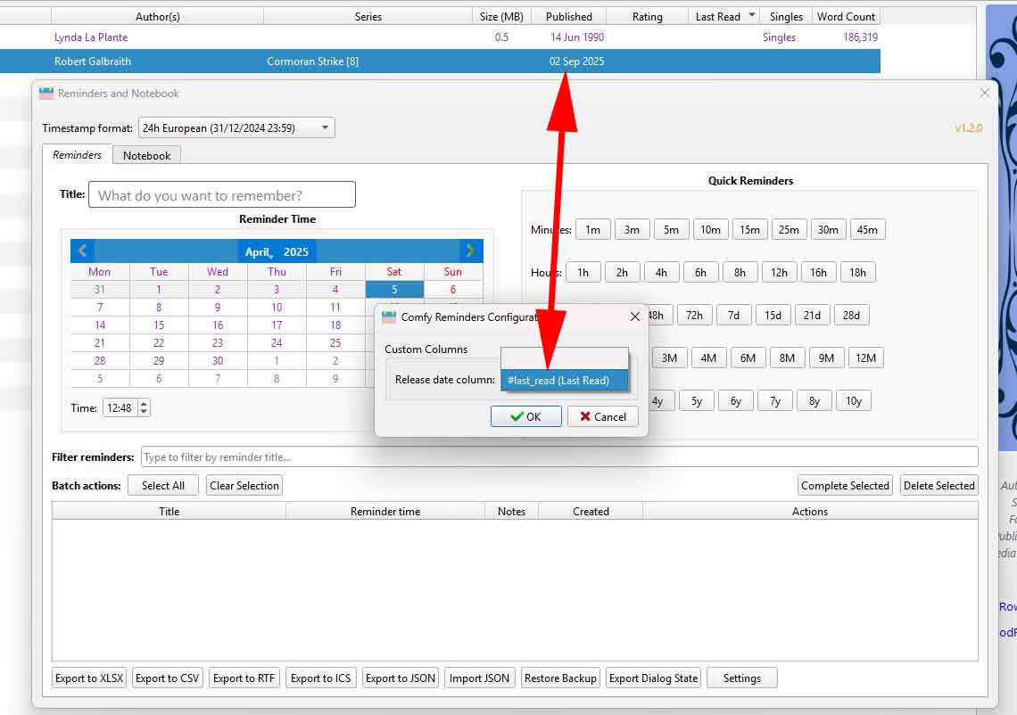

Hopefully I am not missing the obvious again...
I am trying to set the Date column in the Settings for the plugin, but it does not give me the option for the "published date", only the last read date.
How can I change that?

Hmm, that's because current version supports only custom columns. I thought built-in columns could only be past dates, so it wouldn't make sense to add reminders, but I will implement this in the next version.
Old 04-04-2025, 10:36 PM   #23
Comfy.n
want to learn what I want
Posts: 2,465
Karma: 9656783
Join Date: Sep 2020
Device: Libra Colour
In the meantime, you could use a custom date column using this basic template:
{pubdate}
(actually pubdate isn't detected as date column, but this will be solved by adding support for built-in columns)
