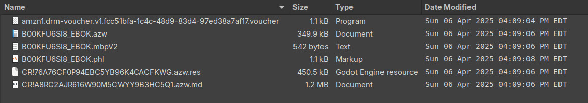

KFX Fail
So, KFX conversion fail. I installed K4PC 2.4.70904 on my wife's Windows 10 laptop and blocked the updates. I downloaded one of the books in my library, stuck it on a thumb drive, and plugged it into my Linux laptop. I have the alpha release of NoDRM, the current KFX Input plugin, and calibre 8.2.1. A screenshot of the files that K4PC downloaded is attached.
I imported the .azw file into calibre, but it showed in my library as KFX-ZIP. I installed K4PC 1.40.65466 on the Win10 laptop, and I got the same result. Any idea what I could be doing wrong?
I am able to successfully import the book KFX file from my KOA3, if that's any help.
Kindle for PC and calibre must be on the same computer and user account, otherwise it's not going to work.
Well, phooey! Thanks for the info, I guess I'll have to stick with transferring from my KOA3 when necessary!
