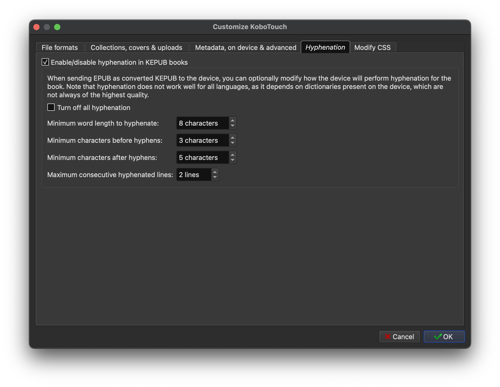

Hey everyone, just wondering, did hyphenation change or break in 8.0.1? I'm curious because I copied my hyphenation settings from the KTE plugin to the built-in KT plugin, and now my KEPUBs are no longer hyphenated.
I've attached my settings in Calibre's KoboTouch driver. Any thoughts? Thank you!

the settings insert the exact same css as the KTE driver did, open one of the files sent to the device and check for yourself.

Ok, so I must admit, I'm approaching the limits of my understanding of EPUB file structure. But I opened the KEPUB file contents, and I don't see a hyphenation.css file present. I think that's the one that contains the hyphenation settings, right?

Not it adds the CSS to a <style> tag in each HTML file. So open one of the HTML files and look there. The KTE driver used ot create a separate css file, the new code doesnt.

Ok, so I opened one of the chapter HTML files, and the only reference to hyphenation I see is:

The -webkit-hyphenate... settings just state True, instead of the numbers in the KoboTouch settings? Again, I could be totally missing it. Thanks!

https://github.com/kovidgoyal/calibr...44ef1c900d0997

Yay, I found a bug and helped fix it! Thanks, Kovid, you're the best!!

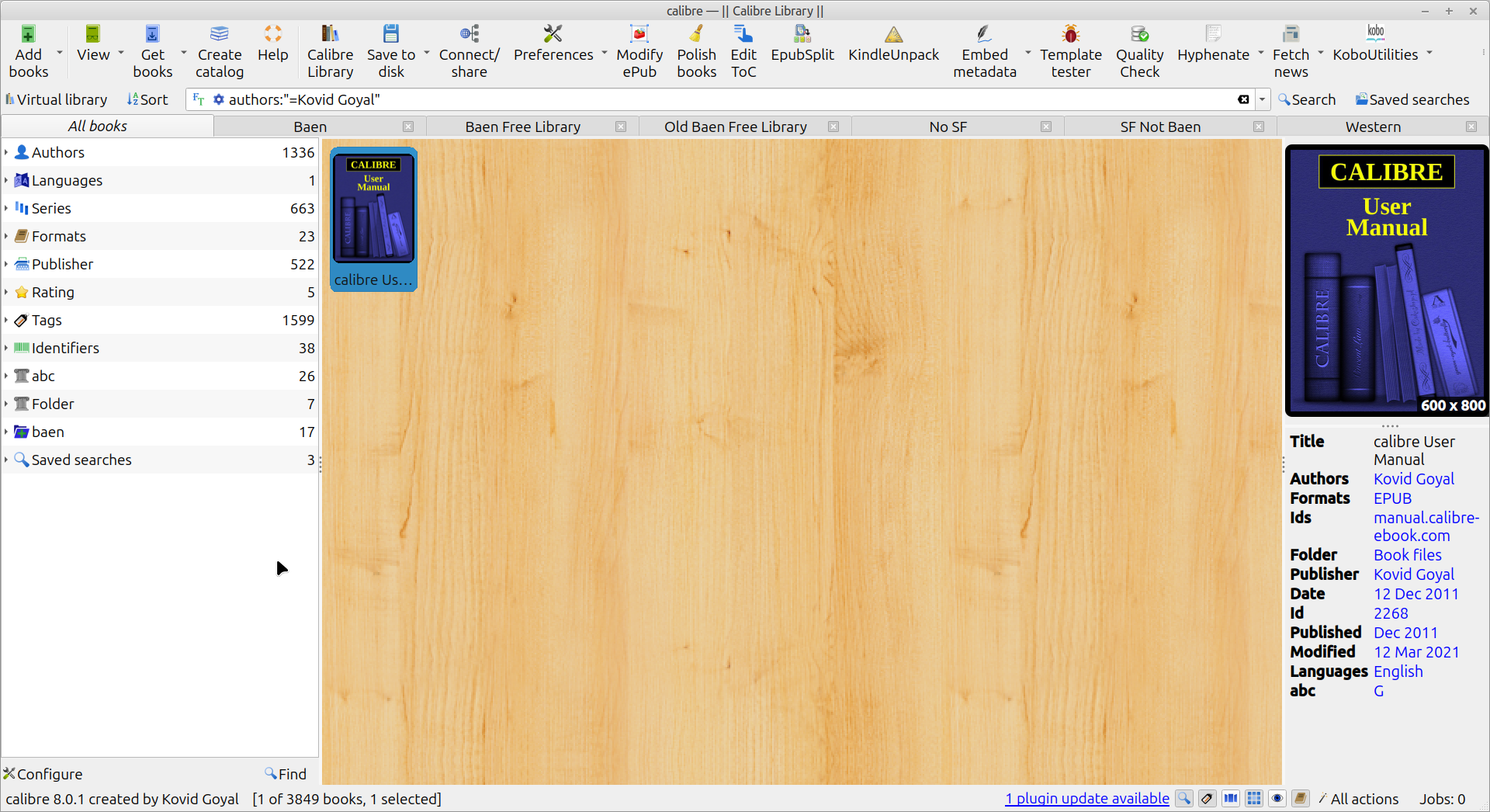

Thank you for Creating Calibre kovidgoyal. I am still learning it. Is there a book or manual or anything to learn more about using Calibre? Tutorials? Thanks again.

https://calibre-ebook.com/help

Copy paste the following into the calibre search bar:
authors:"=Kovid Goyal"
bernie
Name:	Screenshot at 2025-03-26 12-31-44.png
