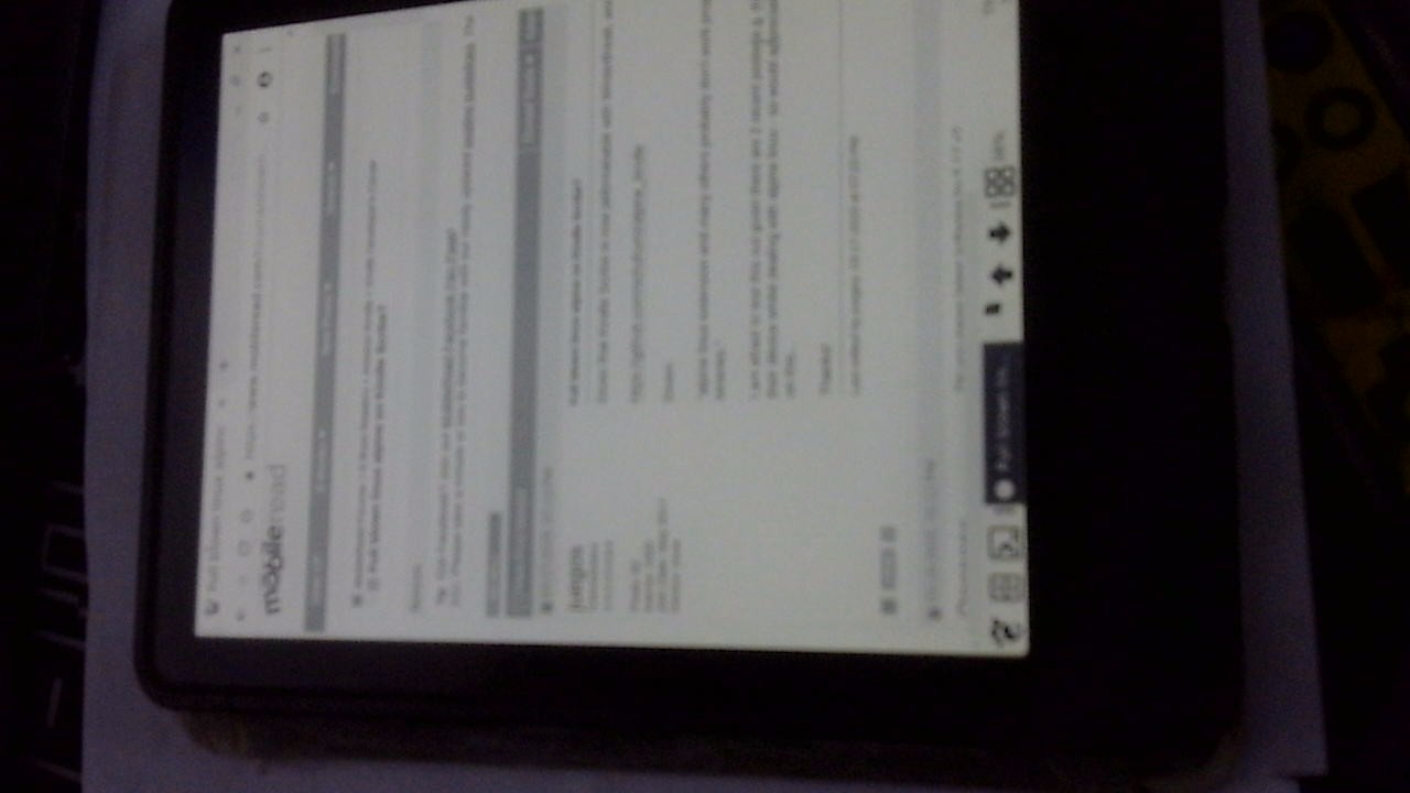

It does work on the latest firmware and Kindle. I am sending this from Alpine Linux.

The image hosting service did not work.
So,
Here it is

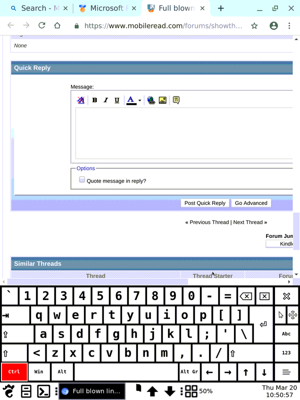

Posts: 84,982
Karma: 153791427
You need to attach the image.

How is it in colour?
The image is the latest one at https://github.com/schuhumi/alpine_kindle/releases/tag/v0.2-alpha2

How do you get the terminal to work properly?
Name:	Screenshot at 2025-03-21 10-50-05.png
