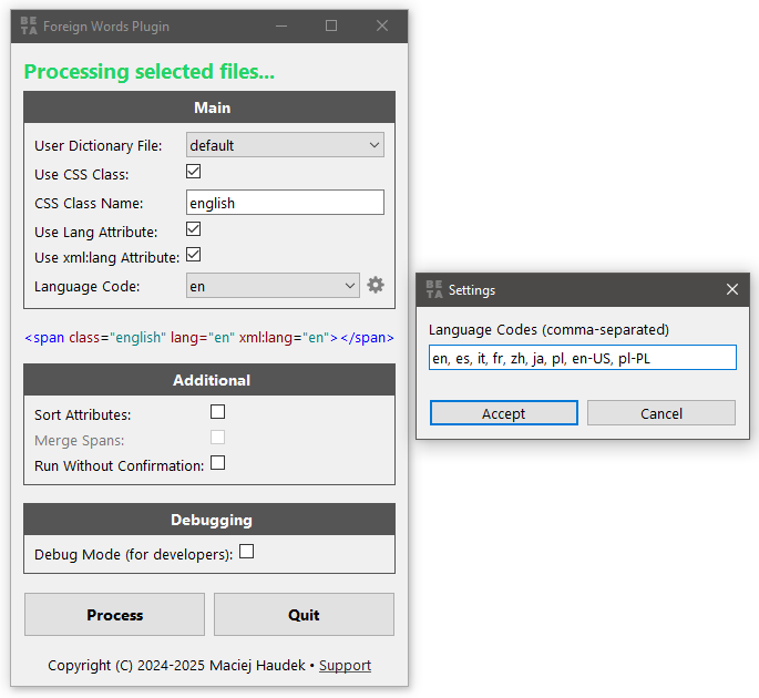

I have been working on such a plugin for some time. I have been following the MR forum for years, but only now decided to register.
Despite my inexperience on the MR forum, can I post a public beta version?
I drew fully from existing plugins, learning from the best. In the end, I chose my path, because, after all, I was creating a plugin primarily for myself.
Although I'm now using it myself, since I really like Sigil, I thought I'd share my work.
Unfortunately, I have not had a chance to test the plugin in an environment other than Windows.
I have tried to test the plugin in various scenarios, but I am aware that its operation can be destructive to files in certain situations if users don't fully understand how it works.
I would also find it very useful to have test files to examine the plugin's behavior in the real world.
New plugins are always welcome. What kind of method does your plugin use to identify foreign words and what languages are supported?

Oh, the plugin is not so clever.
The first step, which is running the "Spellcheck" command and adding foreign words to the user's dictionary, has to be done by a human.
But after that, a bit of magic happens and if we have selected all the words correctly then they will be combined into phrases and surrounded by <span> with the selected attributes.
Today I will prepare a new thread for the plugin and invite beta testing.
I admit that only 10% of the plugin was coding and the other 90% was polishing the interface, but I did it just to make the plugin look good in front of discerning MR forum users.
I know that further testing and code improvements are needed, but without users who will devote their valuable time to beta testing there is little I can do. For my personal needs, I improved a few e-books and it just "worked".
And as for supported languages - I have not tested on languages not based on the Latin alphabet. Probably it will also work for Cyrillic (I have to check it).
I'm not even sure if the plugin will provide support for Arabic, Hebrew or Asian languages in the future.
