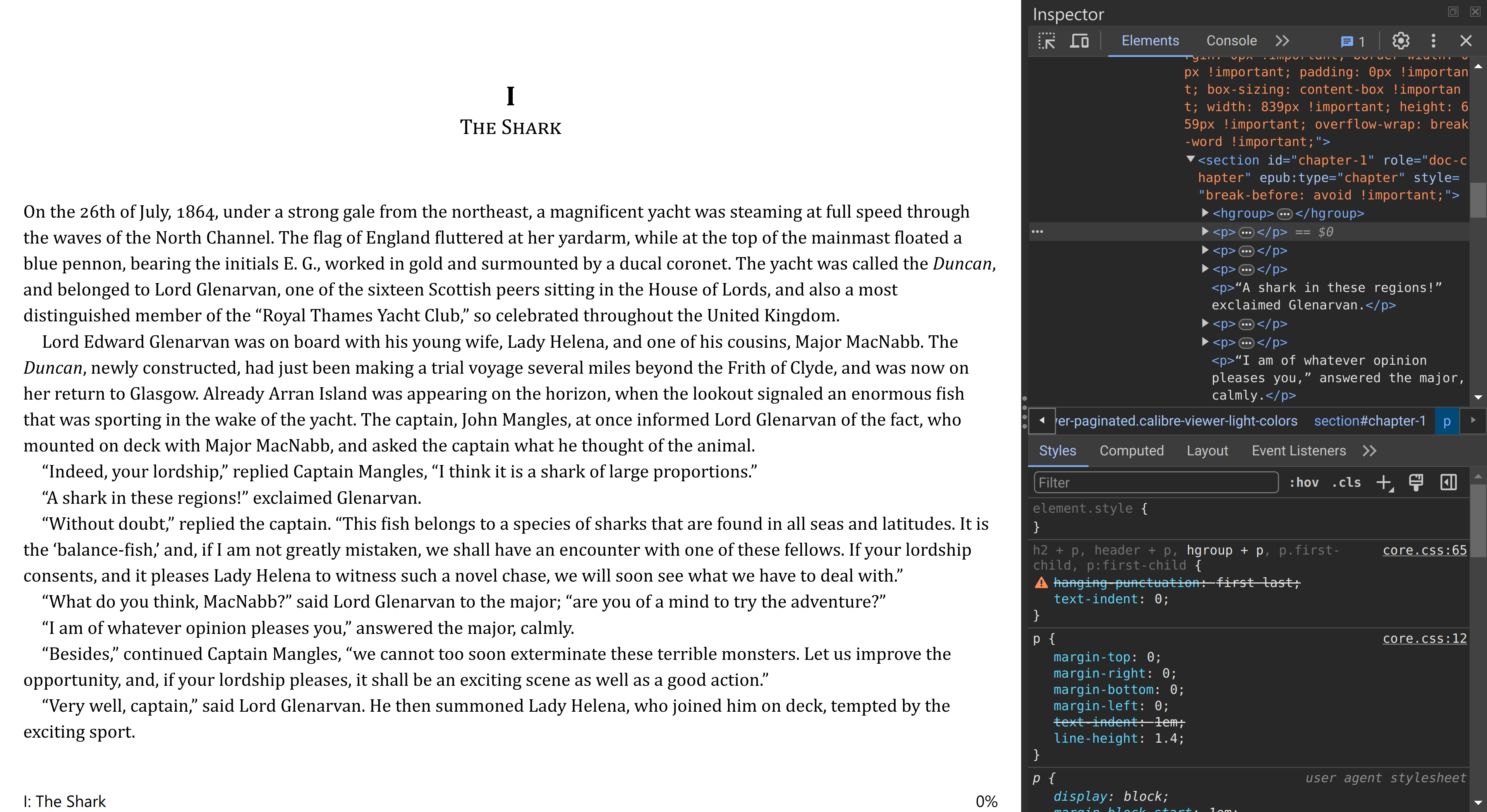

Works for me see attached screenshot, it even shows the effective line height in the inspector of 1.4

I can't really tell from the image if the line-height is displaying correctly or not. All I know is that the Calibre Reader is stuck at a line height of 1.2.
