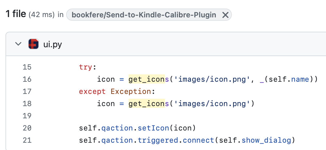

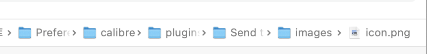

It seems not work. I try to modify the icon of a plugin named “Send to Kindle”. I check the original icon is '/Users/xxx/Library/Preferences/calibre/plugins/Send to Kindle/images/icon.png’. In my icon pack, I created a folder named “send_to_kindle” and placed “icon.png” in it. It’s not worked.
Then I installed the theme “Setenove Blue” which is an icon pack has customed the icon of “Kindle Collections” and I also installed this plugin, it’s not worked too. Something went wrong. Is it only work for other platforms? I only tested on macOS for now.
P1: original icon path of the plugin
P2: icon path in this icon theme
P3: get_icons() function in the plugin’s code

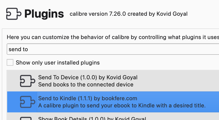

Old 03-03-2025, 03:59 AM   #18
redbreast
redbreast turned on, tuned in, and dropped out.redbreast turned on, tuned in, and dropped out.redbreast turned on, tuned in, and dropped out.redbreast turned on, tuned in, and dropped out.redbreast turned on, tuned in, and dropped out.redbreast turned on, tuned in, and dropped out.redbreast turned on, tuned in, and dropped out.redbreast turned on, tuned in, and dropped out.redbreast turned on, tuned in, and dropped out.redbreast turned on, tuned in, and dropped out.redbreast turned on, tuned in, and dropped out.
redbreast's Avatar
Posts: 31
Karma: 35532
Join Date: Feb 2025
Device: Kindle Paperwhite 3
and here’s the plugin’s name.

Old 03-03-2025, 06:23 AM   #19
Posts: 46,505
Karma: 29634066
The plugin has to do
get_icons('images/icon.png', 'Send To Kindle')
and in your icon theme, there needs to exist the file
Send To Kindle/images/icon.pg
then it will work. From the screenshot you posted, the plugin is using
_(self.name) which will result in a translated version of the plugins name, which could be anything, depending on the users calibre UI language.

Talking Plugin icon works!
Thanks for the hint. After placing the icon in specific folder named by a specific language -- `plugin_name_in_lang/images/icon.png`, it actually works! And that “Setenove” series icon pack seems made a mistake, it didn’t place the icons in `image` folder, no wonder it didn’t work, in a different way.

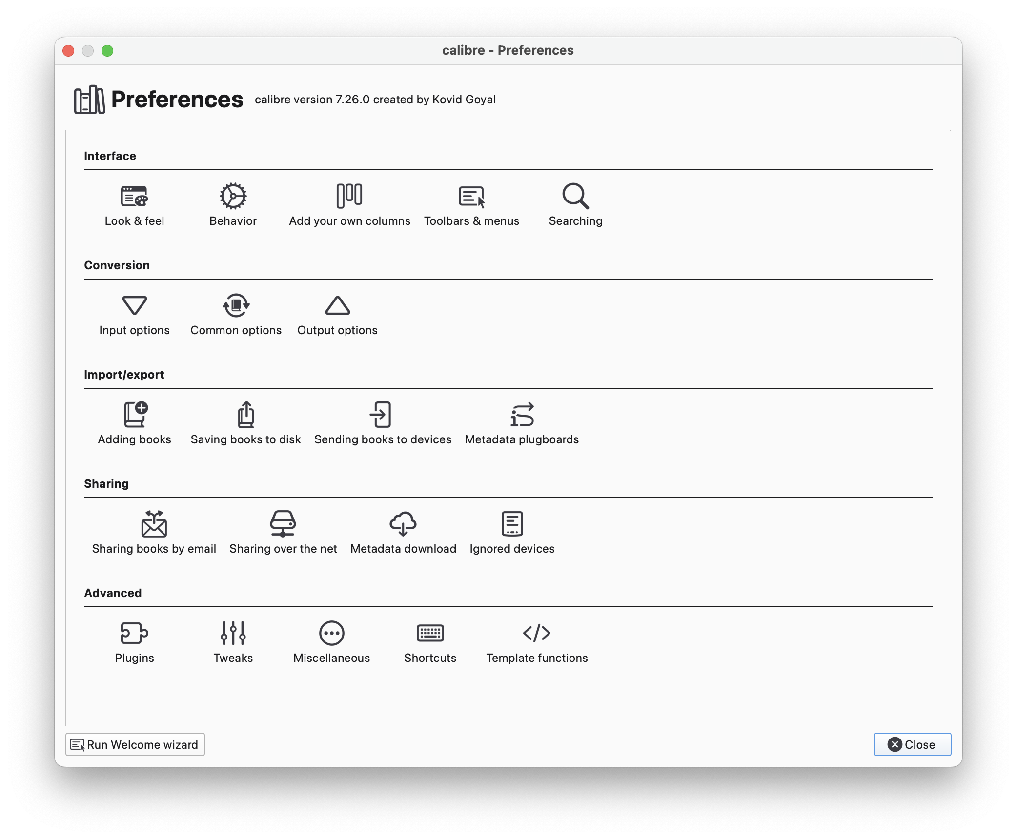

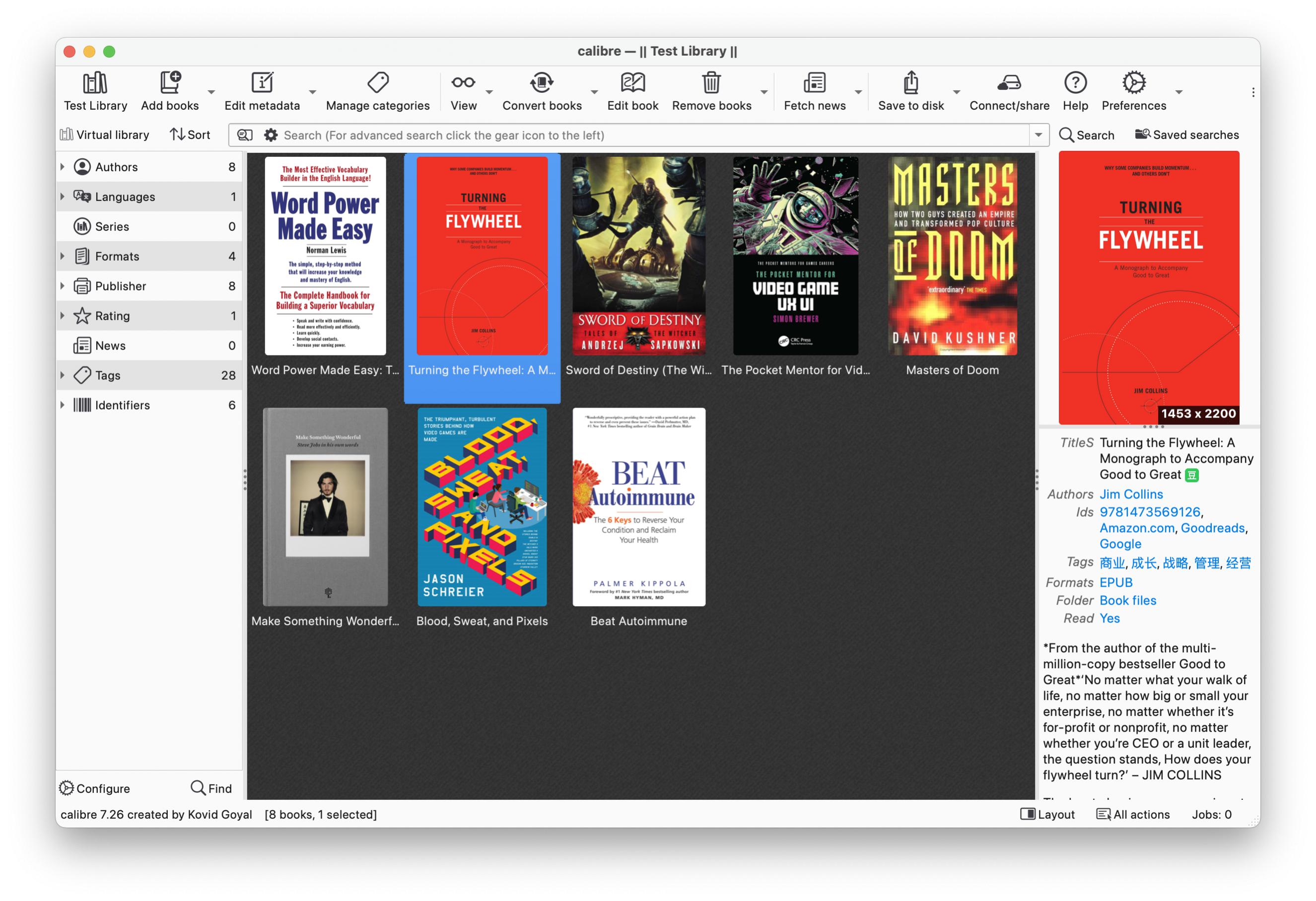

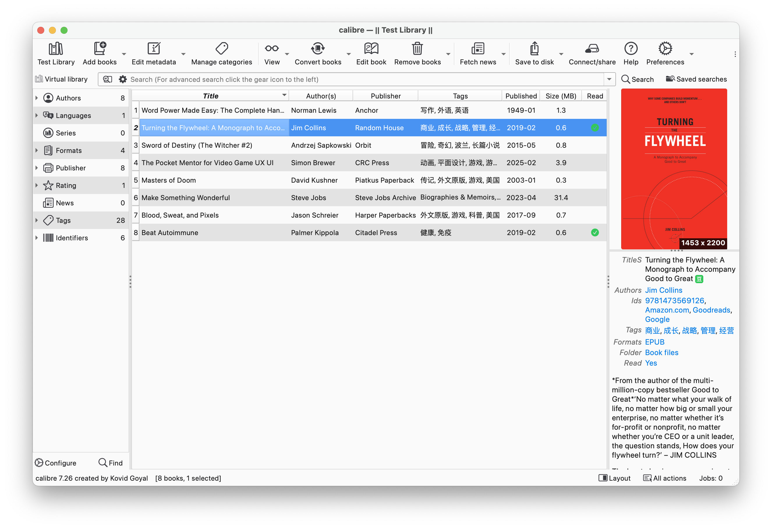

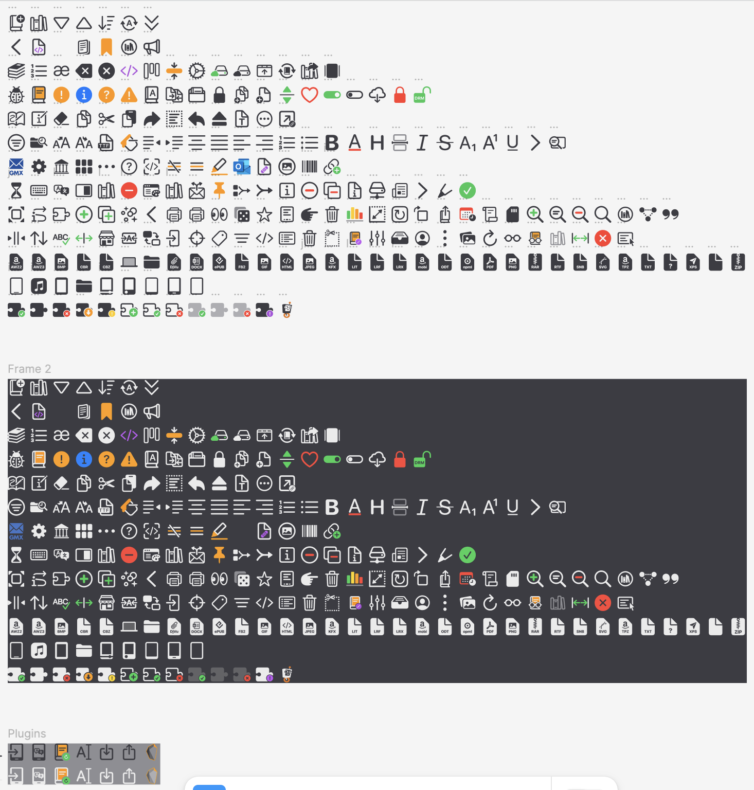

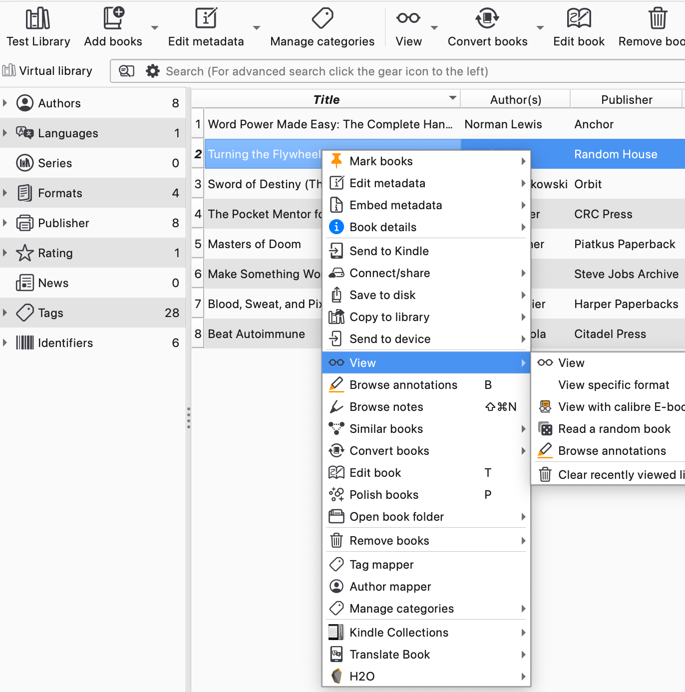

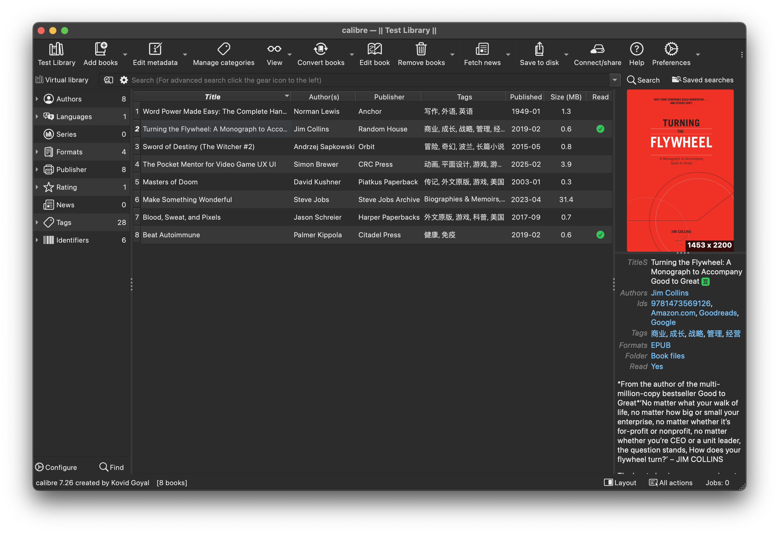

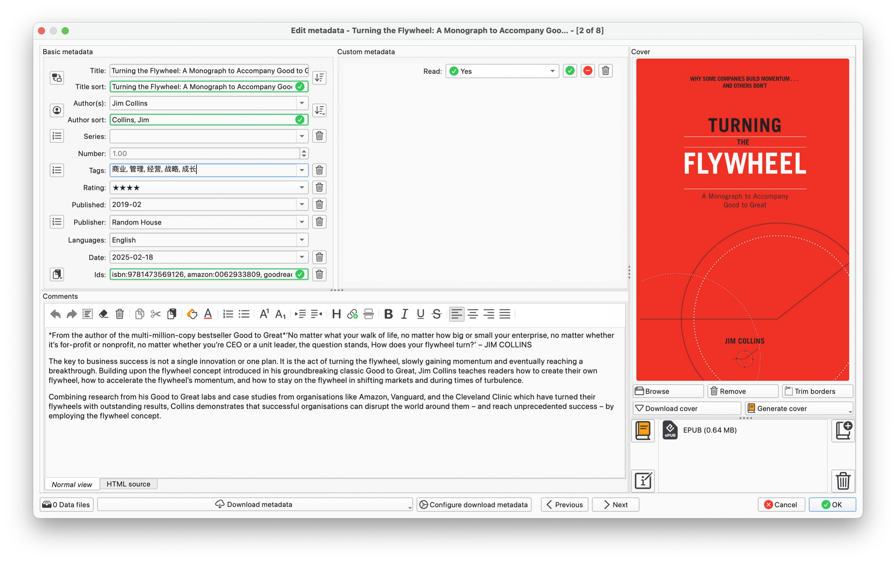

Cool Finally it’s ready for publish!
I downloaded the preview version and packed an icon pack with a working icon theme cover! Finally it’s ready for upload. I’ve adjusted some icons and added some new after the first screenshot. Welcome to download and use and tell me if you like it! Like before, I attached some new screenshots below.
ID:	214152   Click image for larger version
Name:	final shoot.png
ID:	214153   Click image for larger version
ID:	214154   Click image for larger version
ID:	214155   Click image for larger version
Name:	light cover.jpg
ID:	214156   Click image for larger version
ID:	214157   Click image for larger version
ID:	214160   Click image for larger version
Name:	right click menu.png

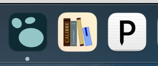

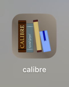

To maintain a consistent visual identity, I've also created an app icon for macOS, which can be used as follows:
1. Copy the library.png (the first attachment), paste it to calibre’s original icon path. (On macOS, /Applications/calibre.app/Contents/Resources/resources/images.)
2. Copy the library.png. In Finder, go to /Applications, left click the Calibre.app then press CMD+I. In the pop-up info window, left click the icon on the top, then press CMD+V.
Then you should get the effect like the screenshots.
ID:	214174   Click image for larger version
ID:	214175   Click image for larger version

Is it still the case that a custom MacOS icon needs to be re-applied after every Calibre update? It would be lovely if this could become the default icon...
fogice is offline   Reply With Quote
Old 03-07-2025, 12:03 PM   #30
redbreast
redbreast's Avatar
Posts: 31
Karma: 35532
Join Date: Feb 2025
I am afraid it needs to be re-applied after update. And here’s a light version I feel better.
ID:	214178   Click image for larger version
ID:	214179   Click image for larger version
