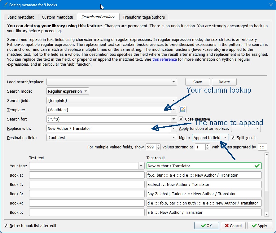

I have a custom column ("Comma separated text, like tags, shown in Tag browser"; [contains names]) which I use for things like pseudonyms, translators, and anthology contributors.
I want to add an author's name to multiple anthologies for which that column has already been populated with other contributors. But if I try to do that via "bulk edit", it'll delete the existing contents of that column for all the select books, and replace them with the the single author name I'm trying to add. Is there any way for me to simply append, in bulk, the author name to that column without deleting its existing contents?

Posts: 31,637
Karma: 64144480
NOT FULLY TESTED Test on a copy Library
Search and Replace (Bulk mode)
(REGEX) Search: (.+)
Mode: Replace <<<normal
Replace: \1 & new name
OR
Mode: Append or Prepend
Replace: new name

chaley
Posts: 12,529
Karma: 8075938
Location: Notts, England
It is easy to do using S&R template mode.

Thank you, both.
My brain straight-up didn't register the "Replace Field/Append Field" optionality. I swear my brain usually works okay...
