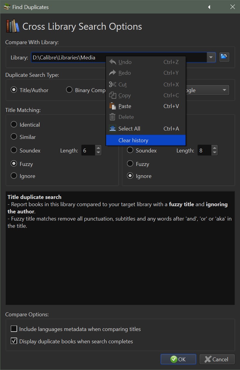

Delete search
How can I remove an unused/deleted library from Find library duplicates?
This is a (UI) house keeping (remove the entry from the History pull down) question ?

Delete search
Indeed: How te remove the entry from the history pull down
Name:	Screenshot 2025-04-08 150656.jpg

Most widgets of this ilk have a "Clear <whatever>" option in the context menu
Right click on the bar where the current library is shown and click on Clear History. Please note that this is an all or none operation.
