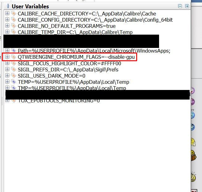

I installed it, but the same issue: it wants the path. I have no idea what the path to QtWebEngine is.
Old 02-28-2025, 07:09 PM   #67
Posts: 22,742
Karma: 34252730
Nope, it's offering to help you find a path with F7 and F8 if that's what the application calls for… but it's not insisting… enter --disable-gpu as the Value.

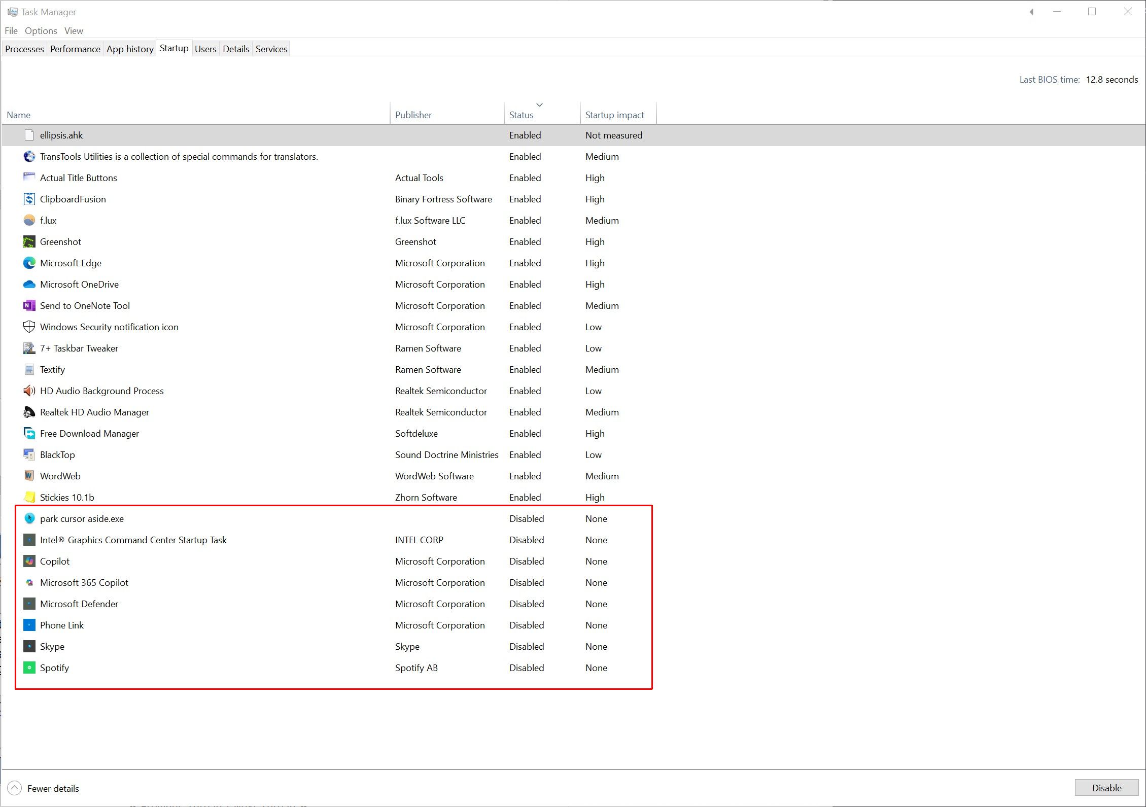

Posts: 22,742
Karma: 34252730
Interference from 3rd party programs most often comes from those that are run at Start up - simplest way to see them is to look in Task Manager Startup tab.
First thing is to disable (button bottom right) the ones you know you don't use, e.g.…
Name:	Screenshot 2025-03-01 123732.jpg
If the fuzziness goes away, problem solved, otherwise disable the rest, if the fuzziness persists the problem is deeper, if it goes away then its one of programs you just disabled… a process of elimination should find it.
Attachment 213984
Yes, those are programs and I only have 4 or 5 of them set to start with Windows. All are programs I need and use. But in addition to those there are a lot of processes running that have nothing to do with those few programs. Drivers, Dell processes, Windows processes and several others I have no idea what they are or do.
Edit: I disabled two of the 5 programs starting with Windows. No change. The rest are the built-in wifi program, audio and Windows Defender notifications - not likely culprits.
