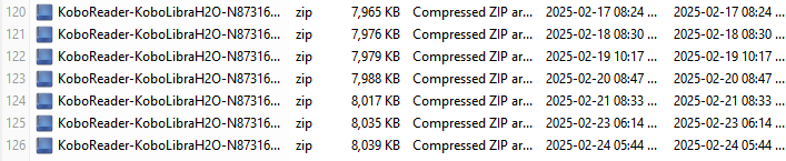

Looks fine to me. "Copies to keep" enabled? I don't have it on.
Name:	2025-02-25 11_52_51-D__Backups_Kobo - XYplorer 23.80.0200.png

Tried now, nothing.
No backup generated.
I'm on the last version of Calibre and the plugin.
Am i missing some setting?

The only setting different to mine is i have copies to keep unchecked.

You need to enable the setting "Backup the device database on each connection".
Probably overrides the setting "Backup the device database daily" so you can uncheck that one.
