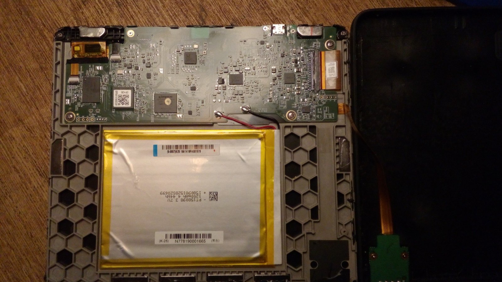

Looks impossible to add a bigger cell inside the case:
Inside of Sage N778 variant.
It looks like built in cell management, so a custom back with a suitable 2 to 4 times capacity single cell might work.
The contacts on the side are for some more complicated system and not USB plus power, sadly.
An updated Sage should be mono, at least x1.5 cell and no power cover. There is space for a much larger cell if the chassis is designed for it. I'd like also back & menu buttons and the page buttons to move scroll /paging in popups such as TOC or definitions or a note. Also some way of turning off /on the BT sleep so if doing a lot of annotation a BT keyboard stays connected. Sadly the notebooks don't work at all with a keyboard except where one pops up, like naming a file.
Also the magnets for the power cover are really annoying and glued in. There might be 8. I did remove two on one Sage and then gave up. Stupid design.
The battery I was looking at was the same size (15,80,98) but rated at 1500mAH with the variant I was looking at having no connector so just two naked wires. I didn't want to order it and then leave it sitting around for a few years.

The Sage battery on mine was just "naked" wires and I can see it has a taped in integrated controller, so likely any cell with the controller built in will work. Very basic soldering iron skills needed, though cutting existing wires (one at a time!) is possible, and some sleeving.
The front has everything except the PCB for the 4 contacts on it, so pop open at other corner and be careful of the flexible pcb ribbon to the small PCB mounted on the rear casing. An old credit card or plastic pry tool just to start. Easily pops back together.
