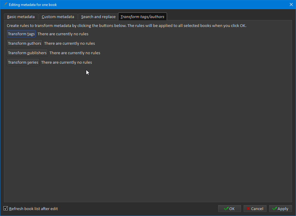

Is it possible to use these in Action Chains? There's no menu option:
Name:	2025-02-23 12_35_07-Editing metadata for one book.png

Old 02-23-2025, 02:48 PM   #1437
capink
capink ought to be getting tired of karma fortunes by now.capink ought to be getting tired of karma fortunes by now.capink ought to be getting tired of karma fortunes by now.capink ought to be getting tired of karma fortunes by now.capink ought to be getting tired of karma fortunes by now.capink ought to be getting tired of karma fortunes by now.capink ought to be getting tired of karma fortunes by now.capink ought to be getting tired of karma fortunes by now.capink ought to be getting tired of karma fortunes by now.capink ought to be getting tired of karma fortunes by now.capink ought to be getting tired of karma fortunes by now.
Posts: 1,220
Karma: 1995558
Join Date: Aug 2015
No. Your best bet to re-create those with templates.
