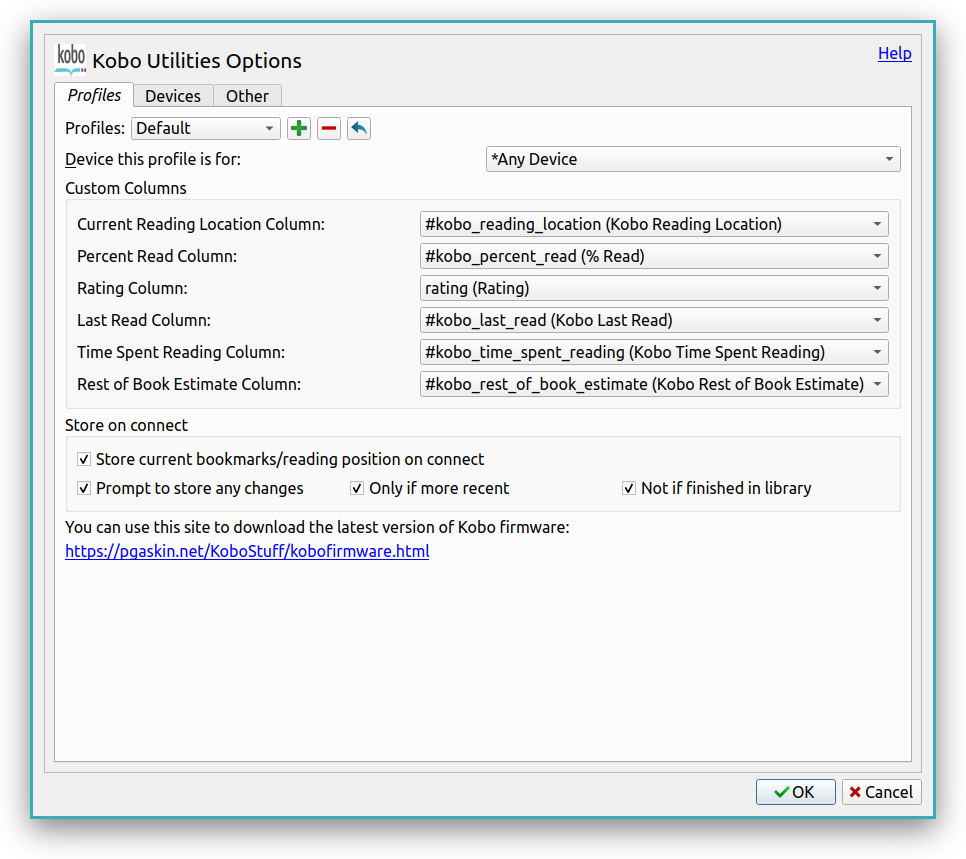

Configuration
Before use, some configuration of the plugin is needed. Pressing the toolbar button will display the configuration options, or it can be reached from the menu. Several custom columns are needed for the full function of the plugin. Pressing the help link will display the help for the plugin. This includes a full description of the columns needed.

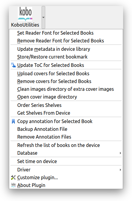

I was checking the list of functionalities listed for the plugin vs the ones I can see/use in the current version, since I know some of them were developed and then discarded after major Kobo firmware updates, and I think it would be best to clean the features list with the ones currently available
Dismiss tiles from tiled home screen.
Is this one still here? I can't find it in the dropdown menu, and if I remember correctly, this one is one of the functionality that davidfor dropped
Manage series info for books on the device. This is mainly for books not in the calibre library including kepubs.
I can still see a "Order Series Shelves" but I'm unsure what it's supposed to do. If I run it, it gives me back a list of my Collections (or Shelves as they were called back then), but no information related to Series. Maybe it was developed back when Kobo didn't have a separated Series tab?
List the books missing from the device database. This only lists the books that calibre thinks should be in the database.
I can only see the "Refresh the list of the books on the device" which seems to trigger a reconnection between Calibre and the device, but nothing related to "missing books"
Set "Related books" for sideloaded books.
I can't find anything for this part either
Features I can see/use on current version that aren't listed, instead:
  • Update TOC for selected books
  • Clean images directory for extra cover images
  • Some additional database functionalities (compress DB, fix duplicated shelves)
  • Easy access to currently in use Kobo-Calibre driver (and easy switch between KoboTouch driver and KTE)
Lys is offline   Reply With Quote
I dont even think it works anymore, does it? Kobo doesnt have the right sort of tiles for it anymore firmware changes.
This should be changes as it's not shelves but collections.

Thanks for the investigation, I didn't think to do that before posting. I'll update the list with your findings.
I checked the code and it's only enabled for firmware versions before 4.4.0. I assume no one still uses a firmware that old so this can probably be removed.
I'm not sure about this, I never used this functionality. Maybe someone knows more about this, otherwise I'll have a look at it when I have some time.
I can't find anything about "missing" books in the code, so I'll just remove this item for now.

Can this ability to show hours and minutes be added in to Kobo Utilities?
That would be nice but unfortunately it's not that simple. The "raw" seconds need to be preserved in a column so that they can be restored to the device if desired, so transforming them on a normal sync wouldn't work.
What could be possible is to have some configuration for each of the two values that creates a secondary column with a configurable format, and which then creates a template similar to the one I posted automatically for the secondary columns. That would be a non-trivial change though so I'm not sure when I might get around to that. I would be happy to accept contributions though.
