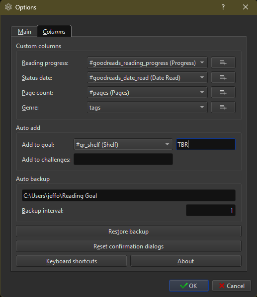

Hello,
I'm trying to use this plugin for the first time. I was able to get the plugin configured, but then after refreshing my data in the goodreads plugin (fixed some dates and refreshed my shelves), then updating the progress on a book I started I can't run the Reading Goal.

Thanks for the reply. It doesn't look like the date is a problem. The oldest date value I have is 2003. It looks like the problem is coming from the Auto Add function.
I thought this function would automatically add all the books on that shelf with TBR as the value, but when I add TBR it throws the error. If I add tbr it don't, but still doesn't add the books.

I'm sorry, but I'll have to insist. The error points the line 1287:
date = date.astimezone()
When you have an invalid date, the astimezone() method fails with 'OSError:[Errno 22] Invalid argument'. The date referred here is the one coming from your '#goodreads_date_read' custom column, not the calibre standard 'Date' column.
The invalid date is present in one (or more) of your TBR books. Please check again.
thiago.eec is offline   Reply With Quote
Thank you, It looks like something was hidden. I reset all the dates on my TBR books as undefined and the error is resolved.

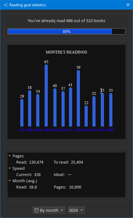

New test version
I decided to add a new graphic for the statistics dialog: daily read pages. To view it, just click on the month name. The combobox will change to 'By day'. To get back, choose 'By month'.
I would like to get some input about this. The idea came from a graphic I saw on Storygraph.
It doesn't add any new information to the database, so no performance issue.
P.S.: This graphic uses Google Charts, so you need an internet connection for it to work.

Old 02-06-2025, 09:41 AM   #734
ownedbycats
Custom User Title
ownedbycats's Avatar
Posts: 11,571
Karma: 81412473
Join Date: Oct 2018
I can't read it to tell where to click.
Name:	2025-02-06 09_40_56-Reading goal statistics.png
It also took 30 seconds to open up, probably the internet thing.
Old 02-06-2025, 11:21 AM   #735
Posts: 82,143
Karma: 150871427
Attachment 213469
Click on the month under the bars.
