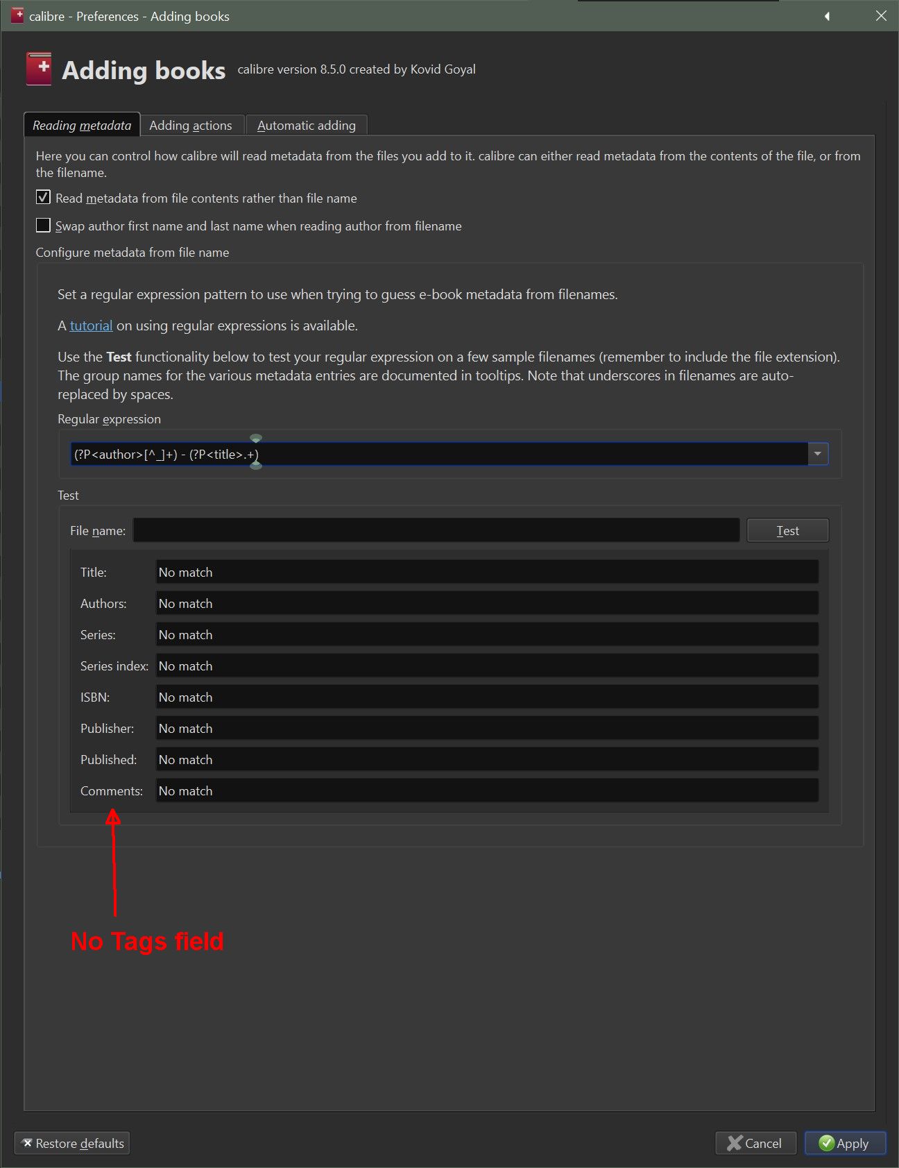

The fact that there is no Test field for Tags suggests to me it's not doable.
Name:	Screenshot 2025-06-21 160735.jpg
Tags is a comma separated, multiple value field.
