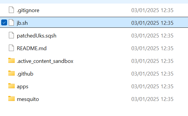

Old 01-19-2025, 11:33 AM   #379
tenigmat
tenigmat began at the beginning.
Posts: 4
Join Date: Jul 2024
Device: Kindle Oasis
Originally Posted by elaineroberts View Post
What files did you copy?
I copied all files in the winterbreak that I downloaded.
Name:	Screenshot 2025-01-19 162922.png
tenigmat is offline   Reply With Quote

Originally Posted by tenigmat View Post
Hi all,
I’ve been trying to jailbreak my Kindle Oasis (10th Generation) using the WinterBreak tool, but I’m unable to trigger the jailbreak. Here are my details and what I’ve tried:
Model: Kindle Oasis (10th Gen)
Serial Prefix: G000 WL05
Firmware: 5.17.1.0.3 (4351880007)
Downloaded the WinterBreak package from Kindle Modding.
Copied the following files to my Kindle:
Safely ejected the Kindle and rebooted it.
nd enabled Wi-Fi when prompted
Expected to see the WinterBreak icon or prompts, but nothing happened.
Is the firmware version 5.17.1.0.3 (4351880007) still compatible with the WinterBreak jailbreak?
Could I have missed a step in the process?
Should I attempt a downgrade? If so, what’s the safest way to do that?
Are there alternative methods to jailbreak my device if this firmware version is patched?
Thanks so much for your help!
Cheers!
After the reboot, you opened the store, enabled WiFi when prompted and did not see the WinterBreak icon? Did you follow the troubleshooting tips on the Kindle Modding WiKi following each step?
When I installed WB, it worked on two Kindle PW4s with 5.17.1.0.3 so the firmware version is unlikely to be the issue.
