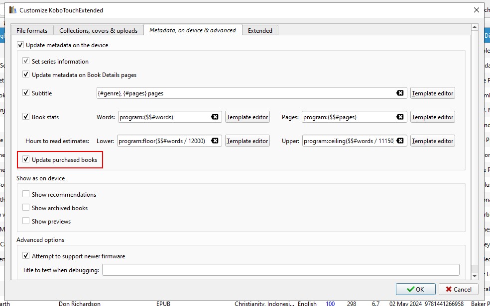

Originally Posted by Rid View Post
Yes I believe it is to the Kobo servers.
New books I buy from Kobo, bookmarks etc. I am one of those people that every month the sync stops working and it can drain the battery from 90% to 10% in 30min. I usually have to delete the larger collections to get it working again.
In my case, I always sideload the book purchased from the Kobo store and manage my own collection with Calibre, so I don't depend on the Kobo sync server. The downside of course the sideload books don't sync with Kobo, but I only read books on Kobo e-reader, so its fine with me.
Edit: I do use Calibre always wondered if that could be an issue?
It won't be an issue if you are using Kobo Touch/Kobo Touch Extended, make sure to check "update purchase book"
Name:	KTE -  Metadata.jpg
