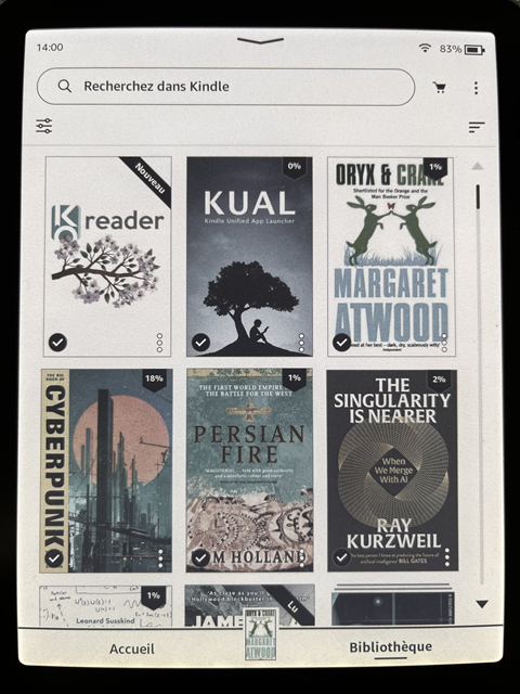

So pretty
I really wish a jailbreak could help fix that infamous yellow border though!

Originally Posted by BionicGecko View Post
So pretty
Does KOReader start? Nobody has reported yet on Colorsoft.
If not, you may need to replace device.lua with
https://github.com/koreader/koreader...dle/device.lua
hius07 is offline   Reply With Quote
Yes, it starts fine with the aforementioned device.lua, and a custom start script from Marek (attached, but couldn't directly attach a ".sh" file so I had to add a ".txt" extension). I'm using the latest KindleHF binary from https://build.koreader.rocks/download/nightly/.
I use the start script instead of KOL as I get hit with the "device not targetted" error when I try to install KOL. But scripts in the "Documents" folder now support icons so I just stole the KOReader icon from the coversetter extension.
File Type: txt KoreaderASAP.sh.txt (155 Bytes, 192 views)
