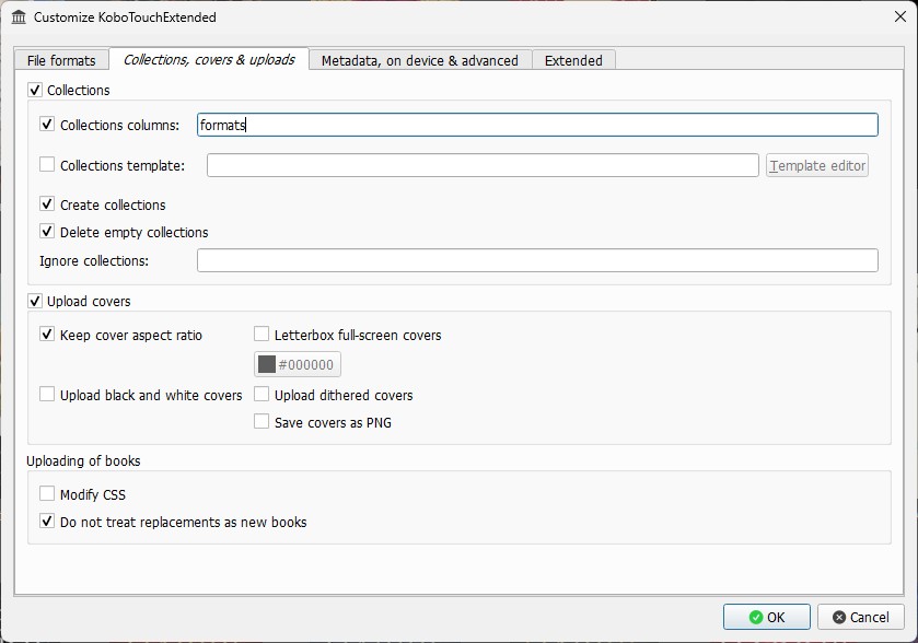

Protoplast26
Protoplast26 began at the beginning.
Posts: 14
Join Date: Jul 2021
Device: Kindle 10th gen and Kobo Aura H2O
My suggestion is:
for books already on the device
inside kobo driver, on calibre, you can customize the collections on the device and show the books grouped that way
Name:	Screenshot 2025-01-03 181401.jpg
for newer books
I think the best option is to use metadata plugboard to insert the format on the title of the book or change the save template to include the format
Protoplast26 is offline   Reply With Quote
Old 01-03-2025, 02:15 PM   #12
Sirtel
Sirtel's Avatar
Posts: 15,831
Karma: 251065365
Join Date: Jan 2014
Location: Estonia
Device: Kobo Sage & Libra 2
Originally Posted by Protoplast26 View Post
My suggestion is:
Attachment 212805
for newer books
The problem with this approach is that Calibre doesn't know which books you sent via the Extended Driver as kepubs and which as epubs. As far as Calibre knows, all books on your Kobo are epubs.

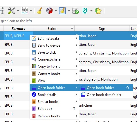

Old 01-10-2025, 05:25 AM   #15
hatuluang
Teluk Biru
hatuluang ought to be getting tired of karma fortunes by now.hatuluang ought to be getting tired of karma fortunes by now.hatuluang ought to be getting tired of karma fortunes by now.hatuluang ought to be getting tired of karma fortunes by now.hatuluang ought to be getting tired of karma fortunes by now.hatuluang ought to be getting tired of karma fortunes by now.hatuluang ought to be getting tired of karma fortunes by now.hatuluang ought to be getting tired of karma fortunes by now.hatuluang ought to be getting tired of karma fortunes by now.hatuluang ought to be getting tired of karma fortunes by now.hatuluang ought to be getting tired of karma fortunes by now.
hatuluang's Avatar
Posts: 166
Karma: 348662
Join Date: Jan 2023
Device: Kobo Clara 2E
Originally Posted by raydawson View Post
What I want to do idealy, using Calibre, is to show duplicate books on Kobo in a window and be able to delete the .epub ones, keeping the .kepub.epub.
However, I can't get Calibre to show the duplicates in Kobo in a window. If anyone can tell me how to do that I would be grateful.
Ray D
Right-click one of the selected books in Calibre to open the folder, and you will find the epub files and epub.kepub files in the same folder under the author name (if you don't change the default calibre directory)
In my case, I keep epub in Calibre library and send kepub to kobo using kobo touch extended.
ID:	212980   Click image for larger version
