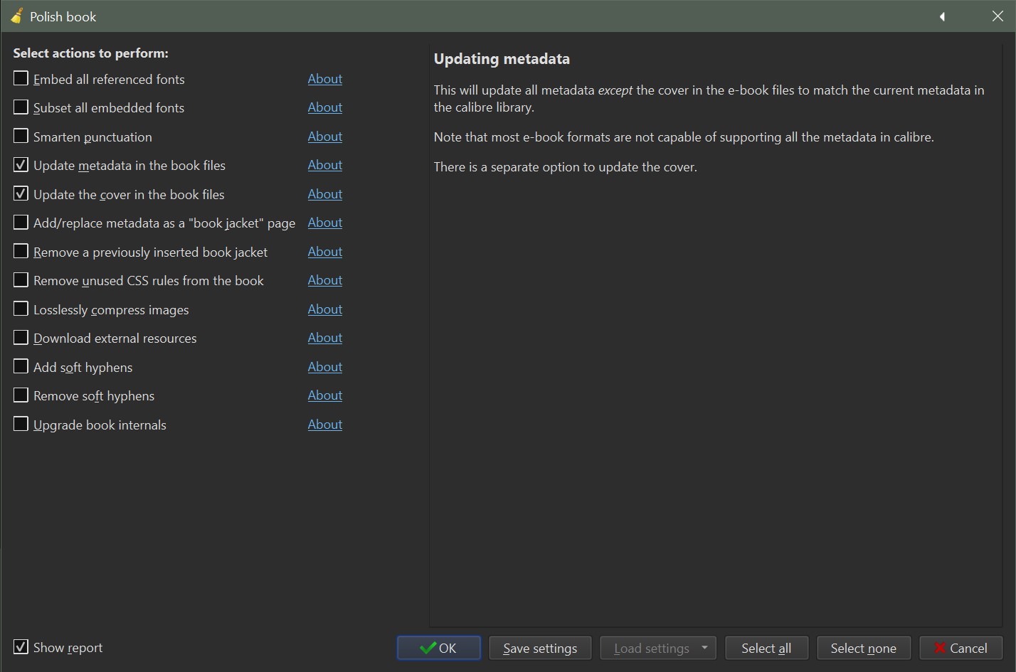

@jlchaps - the simplest way — select the book(s), press 'P', check the boxes in this:
Name:	Screenshot 2025-01-03 093616.jpg
Click OK.

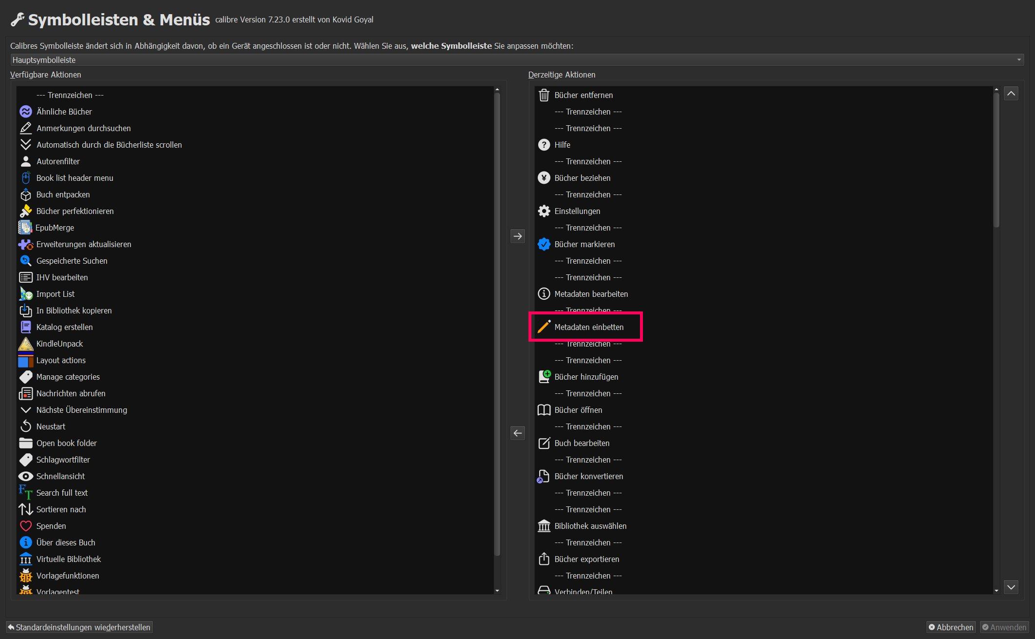

Old 01-03-2025, 06:54 AM   #15
Wiggo
Leftutti
Wiggo ought to be getting tired of karma fortunes by now.Wiggo ought to be getting tired of karma fortunes by now.Wiggo ought to be getting tired of karma fortunes by now.Wiggo ought to be getting tired of karma fortunes by now.Wiggo ought to be getting tired of karma fortunes by now.Wiggo ought to be getting tired of karma fortunes by now.Wiggo ought to be getting tired of karma fortunes by now.Wiggo ought to be getting tired of karma fortunes by now.Wiggo ought to be getting tired of karma fortunes by now.Wiggo ought to be getting tired of karma fortunes by now.Wiggo ought to be getting tired of karma fortunes by now.
Wiggo's Avatar
Posts: 551
Karma: 1717097
Join Date: Feb 2019
Location: Bavaria
Device: iPad Pro, Kobo Libra 2
Strictly speaking, ticking/unticking the Box is not a single keystroke.
I'm clicking on embed metadata.
Wiggo is offline   Reply With Quote
