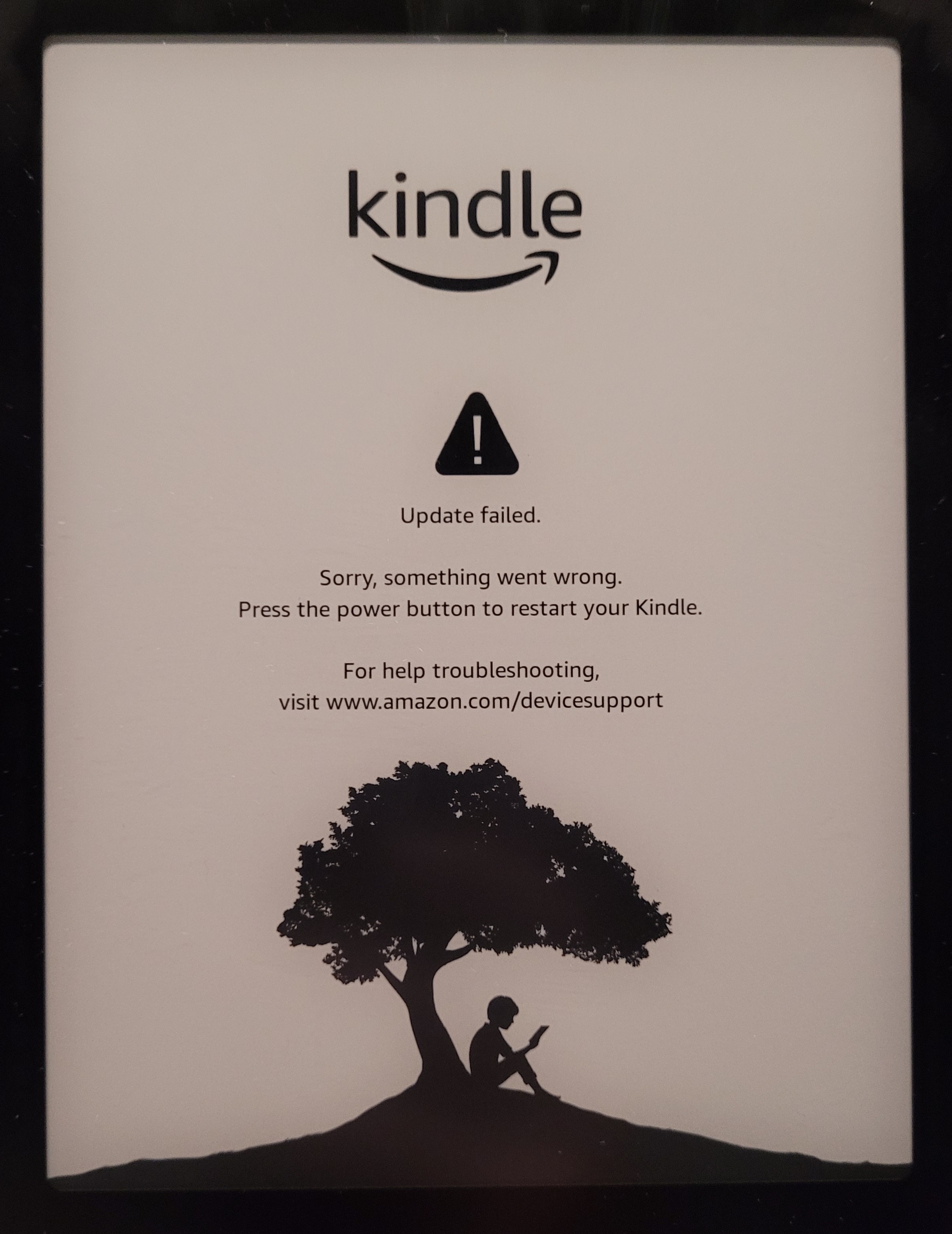

I installed WinterBreak on my PW6 Kids with 5.17.0, but can't install Hotfix.
I'm getting this error:
"Update failed.
Sorry, something went wrong.
Press the power button to restart your Kindle."
Then it restarts automatically after few seconds.
At least no boot loop, it boots regularly.
Any ideas?
vs40 is offline   Reply With Quote

Originally Posted by vs40 View Post
Any ideas?
I got this one, but after reloading and trying again hotifx installed just fine, although I have a problem with error when trying to install mod manager
kirillzel is offline   Reply With Quote
"Update failed.
Any ideas?
May I know the first 6 characters of your Kindle's serial number?
HackerDude is offline   Reply With Quote
GN43 3X06 42
GN43 3X06 42
Try to install the latest version of both WinterBreak and the Hotfix
