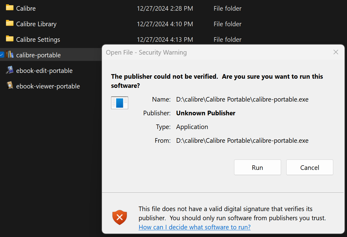

I encountered this certificate error again today. I have attached a screenshot.
I didn't start having this problem until 7.23, and I don't want to have to constantly reapply the update to resolve the error. Is there something I'm missing or something I can do to fix it?

The certificate used to sign calibre on windows expires Oct 2025, so it cant be an expired certificate. And windows shows no issues for me with calibre. I just tried downloading and installing it on my win11 machine. No errors or warnings. Right clicking on calibre.exe in windows explorer and choosing properties->digital signatures shows the signature is OK.
I'm not a windows user so I cant really help but off hand I'd suggest check your system certificates, probably something there is expired/corrupted or similar.
I also looked into the certificate, and I do see what you mean about it saying the signature is OK.
However, I think I figured something out, and maybe this might be why I'm having issues, but I don't know much about this, so maybe I'm mistaken.
Now, I'm not sure if it makes a difference, but I'm running the portable build of calibre on an external hard drive. I'm not using the windows installer.
I've run this on two separate win11 machines which previously had no issues, but for some reason, updating to 7.23 eventually causes certificate errors.
As stated in my previous post, when I reinstall the 7.23 update, I am able to launch without issue, but then I didn't use it for a couple days or so, came back, and I got another certificate error again.
However, here is what I figured out. When I'm trying to launch calibre, I'm using the "calibre-portable.exe" launcher in the "Calibre Portable" directory (I've always launched calibre via this .exe). I noticed that "calibre-portable.exe" does not show a certificate on it. However, "calibre.exe" under "Calibre Portable/Calibre" is where the certificate shows up. Is this how it typically should be, or am I missing a certificate?
swordthief is offline   Reply With Quote
Old 01-02-2025, 07:31 AM   #8
Posts: 45,645
Karma: 28549046
all exe's and dlls are supposed to be signed in the calibre app bundle itself. I cant recall offhand whether the portable launchers are signed or not, possibly not. I suppose I can sign them as well for the next release. The actual portable installer is already signed though.
