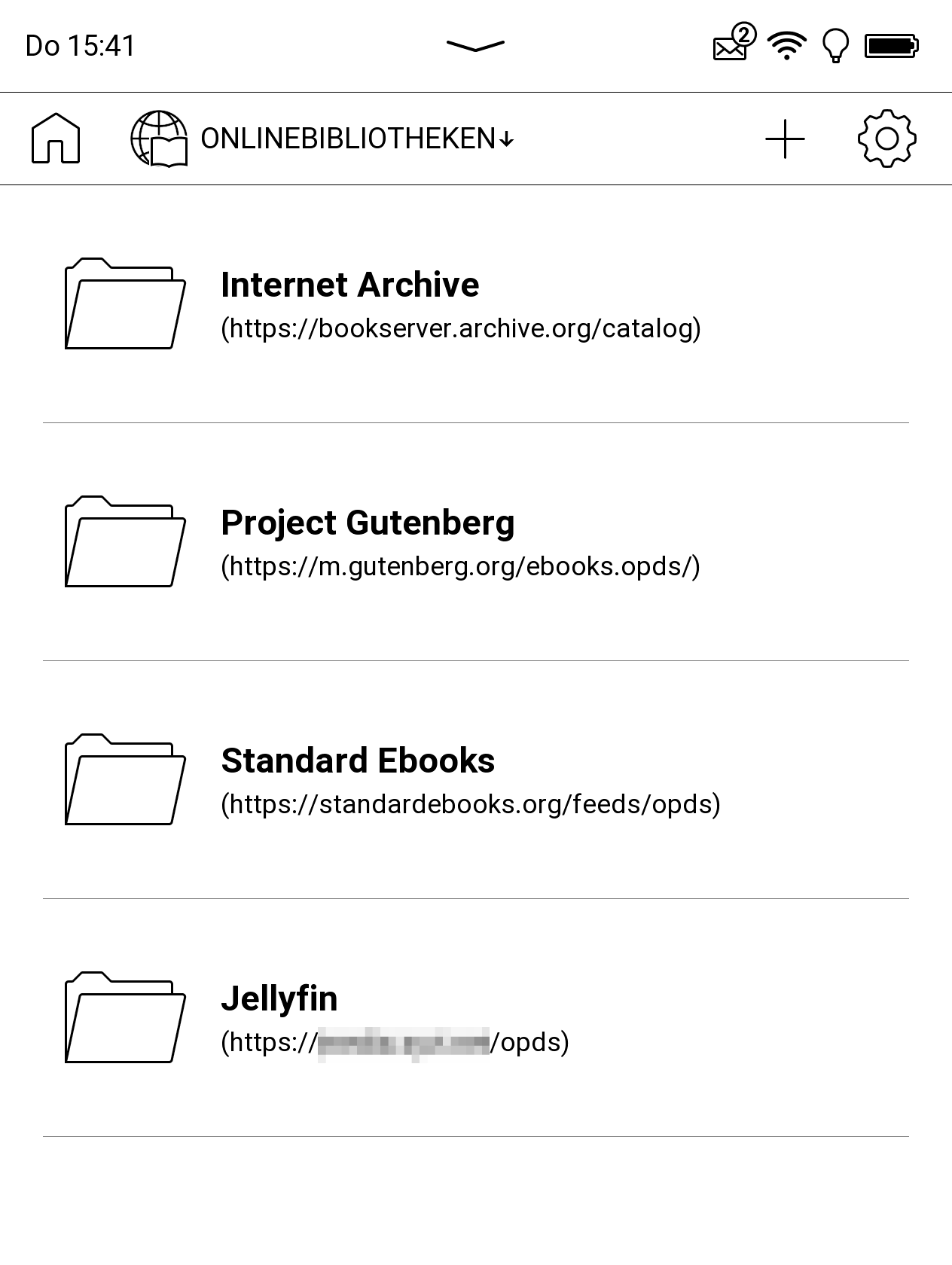

@neil_swann80: Thanks a bundle for your installer!
Confirm working on my Pocketbook Era (PB700) with firmware U700.6.8.4183.
After installing, should I remove the EnableOPDS_v4.pbi via USB, or on the device?
(No need for uninstalling, so I think it can be removed.)
Darn. Now I modified my PB Era to mainly check for new books on Standard Ebooks, they started to force a $15/mo or $150/yr subscription system for feed access. I wonder why my (non-subscription) Foliate and Thorium feeds still work.
Last edited by Moonbase59; 06-26-2025 at 11:57 AM. Reason: Add Standard Ebooks info
Moonbase59 is offline   Reply With Quote
