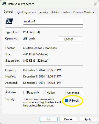

Please help, I'm trying to install KoReader on my new elipsa, version one, and when I tried to Run the instal.ps1 file with power shell, just start the power shell and close directly. Nothing happen else. My Kobo connected and everything fine except the install file doesn't want to start so I can choose to install koreader.
My windows is 11. Any idea why is that?
https://ibb.co/B254gBf

As per item #3 in the Windows install script section, did you unblock the PS1 file? See the attached image. Otherwise, I would suggest opening a Powershell session, CDing to the directory where the script and the .zip file are and then typing .\install.ps1 (Powershell does not look in the current directory by default) which should at least let you see any error messages that might be generated.
Thank you for your advice, but unfortunately doesn't work with me with many different type of orders and I did check the box for unblock, but I found the solution to order Powershell to bypass the security and install, and WELLA everything working fine and installed smoothly
As you said, after opening Powershell and go to the same files directery, I give this order
powershell -executionpolicy bypass -File .\install.ps1
and after the order as you know asking me for what I want to install and that's it.
Please help others for this order as maybe the Windows 11 making more hidden security for Powershell.
Thank you anyway and hope everybody get the benefit.
