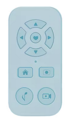

I just bought a bluetooth remote with the name Beauty-R1 as well (looks slightly different but I'm assuming it's set up the same) and tried to set it up to no avail for the past few days but I finally figured out a configuration that works.
nextPage EV_KEY KEY_VOLUMEUP 1
prevPage EV_KEY KEY_VOLUMEDOWN 1
To turn the page, just long press the up and down buttons on the remote. Sharing it here in case anyone bought a similar device and was struggling to get the code working like I was.

Beauty-R1 - Need help!
I also have a device whose Bluetooth name is Beauty-R1, but the model number is DY10 and it has 9 buttons in total. I've attached what it looks like to this comment.
The arrow buttons work as a mouse on my Android phone (there's a icon and it can swipe).
My Kobo Libra 2 can connect to it via Bluetooth, but it doesn't appear in my Kobo's /dev/input folder.
Can anyone give any advice or suggestions on things to try? Thank you!

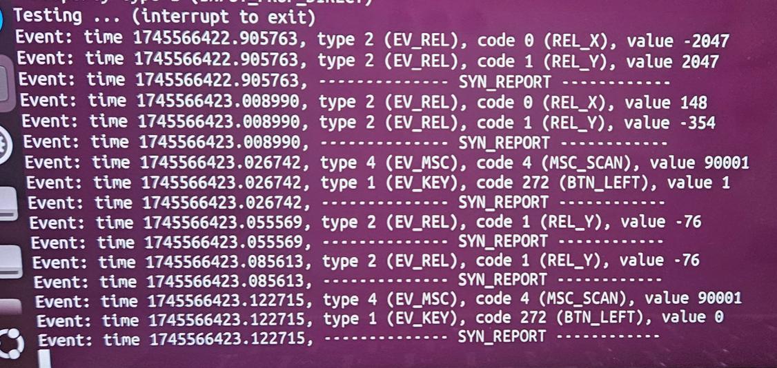

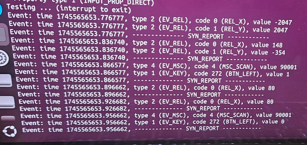

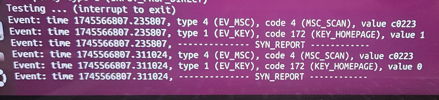

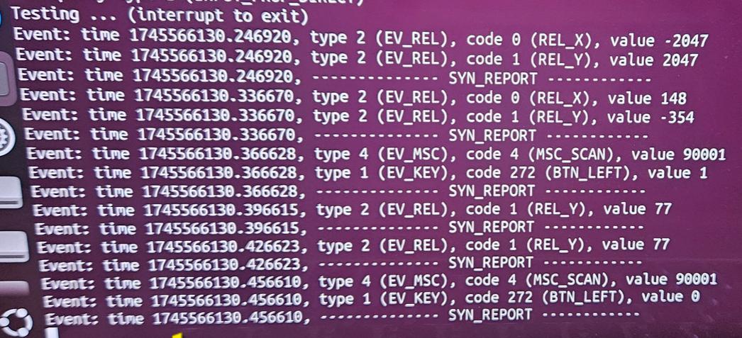

# Evtest output
I've uploaded some evtest output for the various buttons, sorry it's an image as I had to boot Ubuntu from USB in order for the Bluetooth Beauty-R1 to be detected (VM didn't work!)
I also uploaded an image of the udevadm info of the device.

Can I ask what does your Beauty-R1 look like and did you have to install any drivers or modules into your Kobo? Thank you

My Beauty R-1 device looks like this:
Nope, all I did was follow the instructions in OP's post and instead of the example config posted in GitHub, just use the config I posted above. Hope that helps!
