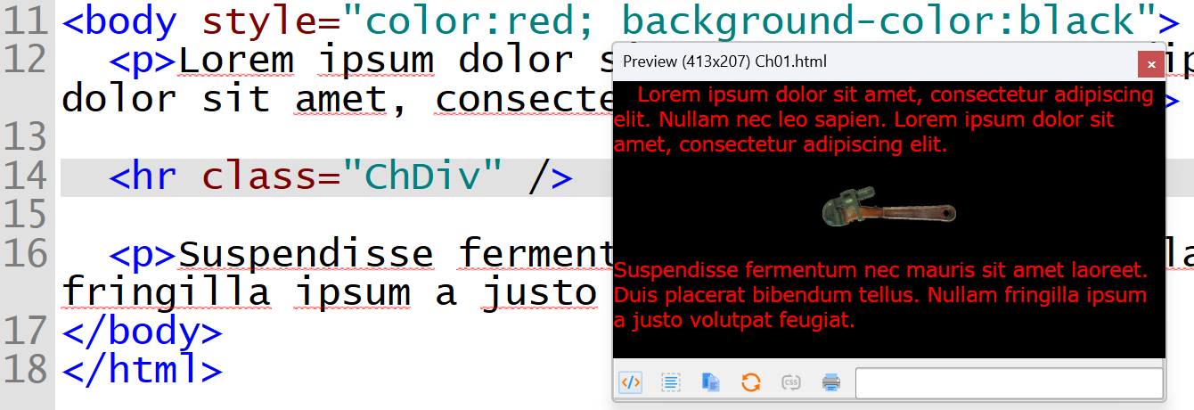

Just for a complete answer:
If you wanted the detail available with a .png image I would change the css to something like this:
hr.ChDiv {
  height:2em;
  background: transparent url("../Images/Wrench.png") no-repeat center;
  background-size: auto 100%;
That would give an image like this - what we are normally used to seeing with a png image:
